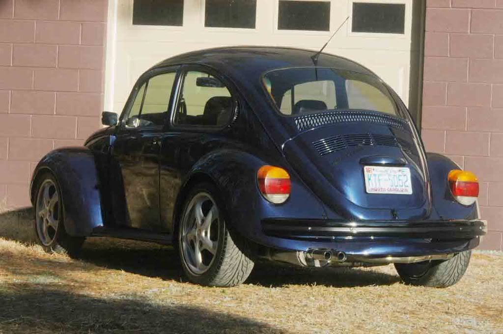

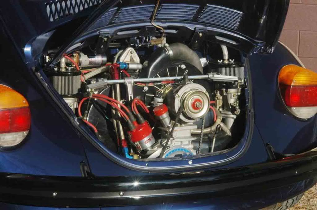

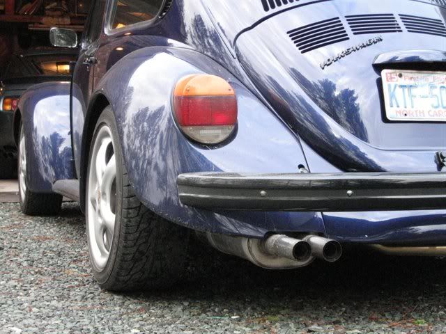

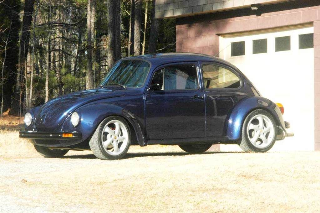

Here's mine, for inspiration.
http://i273.photobucket.com/albums/j...2-29-08011.jpg
http://i273.photobucket.com/albums/j..._1658-copy.jpg
http://i273.photobucket.com/albums/j...C_1665copy.jpg
http://i273.photobucket.com/albums/j...C_1664copy.jpg

The reason I have one is because of what Byron said earlier about the interchangeability of 944 brake and suspension parts, and any Beetles interchangeability with 914 engines and gearboxes. Having all of the design similarities gave me an easy opportunity to make it into a completely different car that doesn't drive like a boring Beetle, or an amped up hotrod either.

Craig, the brakes are all straight off an '86 944S. The front spindles and strut tubes are off of an earlier 944, but I don't know what year, and the rear control arms, and spring plates are off an '86 951. The master cylinder is for a 930. The only mods I had to do were to cut the spring perches off of the strut tubes so I could install threaded collars, install a tie-rod flip kit on the spindles because the 944 spindles have different tie-rod orientation than a Beetle, and I also had to remove some steel from the bases of the rear shock towers so the spring plate adjustment bolts would have some working clearance
jyl, mine drives sort of like a 911, but it's not quite the same because of the longer wheelbase. It's feels more forgiving, and having less weight behind the rear axle lessens the pendulum effect. I made aluminum braces to tie the rear frame horns to the rear shock towers, and tie the shock towers together, plus a brace in front to tie the strut towers together, and also to the framehead. That did wonders for the rigidity of the chassis, but it's still not as stiff as a 911 tub.
Tobra, you're right about power-to-weight. I have about 160 hp from a 2270, and maybe about 2100 lbs of car. The spring rates are kind of steep. I used 944 torsion bars in back, and aftermarket Superbeetle springs in front that were rated @ somewhere like 85 lbs/in, and have out-of-the-box Bilsteins front, and rear. I had to send the fronts back to Poway CA. to have them shortened 2"

You can do the brakes and suspension for less than $2k if you find a 944 lacking enough value to justify it's necessary repairs. Or you may find someone that's upgrading to S4/951/968 brakes, and will sell their old parts for cheap. Even though the ATE calipers are bottom drawer parts on a 944, they're a shade below overkill on a Beetle because of the weight difference. Building the braces for the frame horns, and strut mounts, however is not that much cheaper than buying them already made unless you have a TIG, and a lathe you can borrow...
The engine, as with any, can be as fast as you can afford to make it, but even a bone stock 2 litre 914 is 43-47 hp over a stock Type 1, with a gob more torque, and will last a very long time because of the extra heat sinks on the heads, and aluminum case. All that you have to do is convert the cooling system, and nix the D-jet (or sometimes L-jet) for a pair of carburetors. A stock tailshifted 914/901 gearbox mates right to it, has the right ratios, and is relatively easy to convert to a rear-engine configuration.
