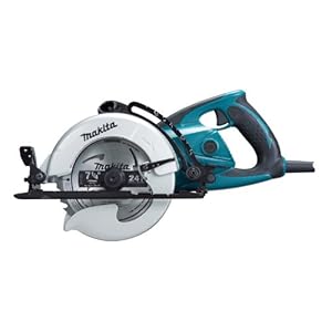

legion 09-05-2011 07:39 PM
Update:
I went to the local AC motor place and they found brushes that would fit...sort of. The brushes would fit in the brass tubes, but didn't have a flat back so wouldn't fit back into the saw.
My wife bought me this for my birthday:
Amazon.com: Makita 5477NB 15 Amp 7-1/4-Inch Hypoid Saw: Home Improvement
http://ecx.images-amazon.com/images/...500_AA300_.jpg
It's a very nice saw, much narrower than the old one, which makes it more useful to me. I just used it to cut some 1.5" stock, and it cut like a hot knife through butter. I hope to never own another circular saw again.

That's a real accurate saw that can attach to a their own guide system. it is suppose to be as accurate as a stationary table saw. It will not last long at a regular construction job site doing the job of a worm drive saw. it is a totally different tool all together. I own their sliding miter saw. It is a shop tool only, no job site use. It is close to 50% more then other similar saws but very accurate and well built. I would buy a Makita or Bosch for a little more then half the price. It can do the very same job. I would not buy again.
look 171 09-05-2011 09:15 PM
Originally Posted by legion (Post 6238141)
Update:
You wouldn't need to get another one. That hypoid gear is a robust tool. It took me more then 8 years to kill my last one. That's because a guy throw it off a roof and broke the handle.
