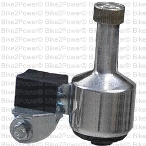

VincentVega 07-03-2012 07:31 AM
SpinPOWER I4 iPhone 4 Bicycle USB Charger KIT
Amazon.com: SpinPOWER I4 iPhone 4 Bicycle USB Charger KIT: Cell Phones & Accessories
http://ecx.images-amazon.com/images/...SL._AA300_.jpg
red-beard 07-03-2012 07:40 AM
Originally Posted by VincentVega (Post 6836884)
I like your idea, but this is much more serious
Shimano Hub Generators and lights
http://sheldonbrown.com/harris/light...ages/huh12.jpg
6VDC
Shimano Nexus Generator Hubs For Bicycles
VincentVega 07-03-2012 08:03 AM
True that. I remember using a similar clamp on generator powered light when I was a kid delivering papers. Nice option that you can remove it simply and make it fit just about any bike.
I only have experience, and not that much, with solar on my boat. Cool idea, but unless you have large panels that track the sun, it's hard to get enough power to run much equipment. Neat idea to add battery capacity but weight and complexity starts to add up.
