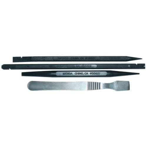

What about taking it apart, or opening up some of the covers? Opened up many a pc, but never a laptop.
Scott R 11-23-2012 04:18 PM
One thing about taking laptops apart is it's nice to use plastic tools to work on them. It's so easy to damage the case taking the apart with conventional tools.
