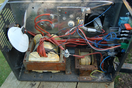

Schumi 03-08-2013 11:54 AM
Pulled this pic of the inside from another forum- this is the machine, it is a SIP Migmate 150
http://www.mig-welding.co.uk/forum/a...1&d=1271444280
The input wires are at the bottom right- a brown, a blue, and the yellow/green come from the mains cord. The yellow/green is the ground and goes straight to the chassis.
The brown and blue were load and nuetral labeled. It is these two that expect a +230v, -0v connection. I'm going to be giving them +115v, -115v. Total waveform amplitude is the same, so RMS power is the same.
That is my thinking.
Zeke 03-08-2013 05:38 PM
That appears to be an older welder with transformers. I'd hold off until you get more info. Me, I don't have a clue.
Or a transformer and a rectifier and I don't know about those either.

Schumi 03-09-2013 02:19 PM
Well, I just tried it and it works just fine off the dryer outlet. Thanks for posting that on GJ Zeke.
It's not the best MIG I've ever used but it does the job. Most of the work I'm going to be doing I will use my new TIG for, anyway. This thing might get used for tight spot seam stitching or just tacking things together before finish TIG-welding them.
