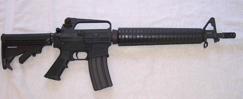

Originally Posted by HHI944 (Post 7857254)
A dissipator would require the firearm either be an SBR or a Pistol.
No, a "dissipator" was a model Bushmaster sold with a full length handguard and sights, but a 16" barrel. Think of a standard A2, but instead of having ~4" of barrel forward of the front sight, you don't.
