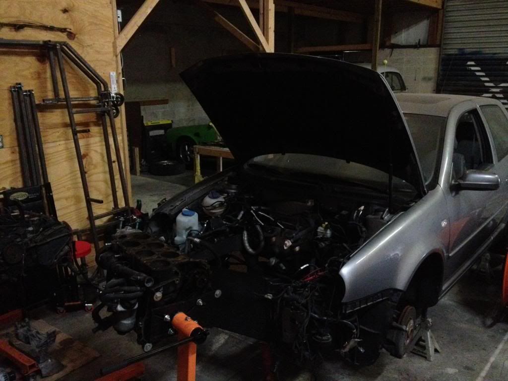

Here are some pics of it in progress. After looking back at them, I realized how crappy they are and that somehow I missed most of the detail shots... I guess it's because I usually waited to pick the phone up after I had degreased my hands, typically at the end of the day. At any rate, enjoy...

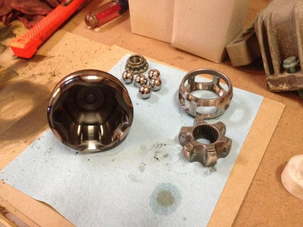

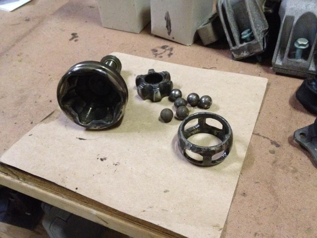

Here is an example of a CV joint that I was able to clean up and repack:
...and one that had water in it and was toast:

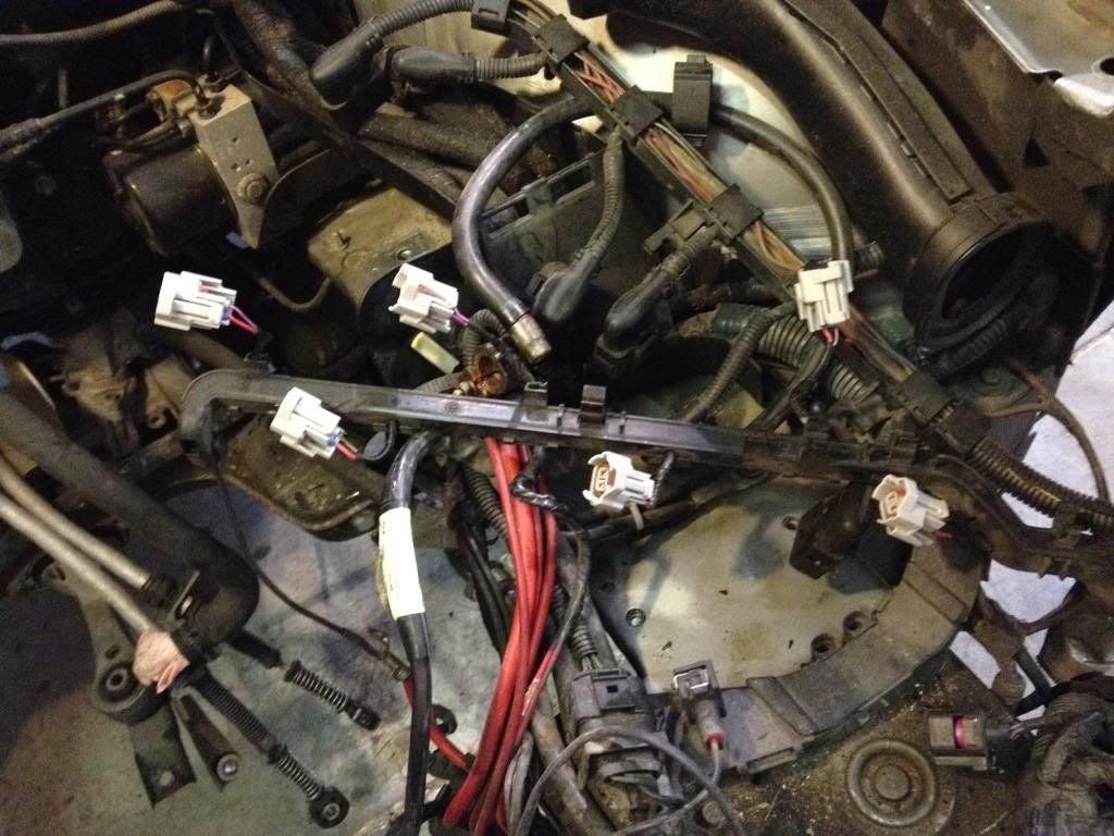

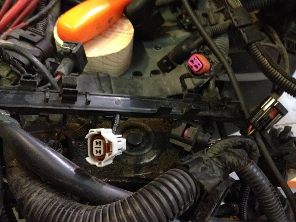

These next two are of the fuel injector electrical connectors. The original ones were so brittle when they were removed that they all fell apart. I found an connector vendor that sell new ones... well, they are Denso for a Subaru (I think) but they are essentially the same and worked great.

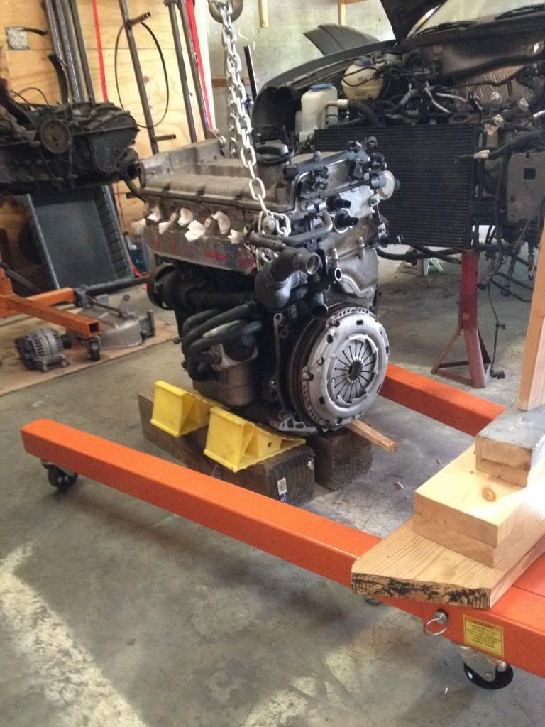

But those were the teaser shots, here's more

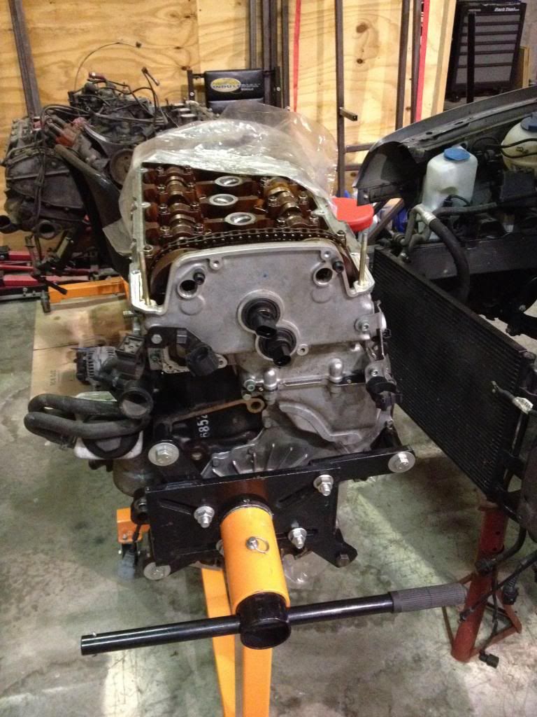

Here's the engine with head and timing covers installed:
...and a couple of it off the engine stand, awaiting mating of that transaxle (I don't have a shot with the transaxle, unfortunately

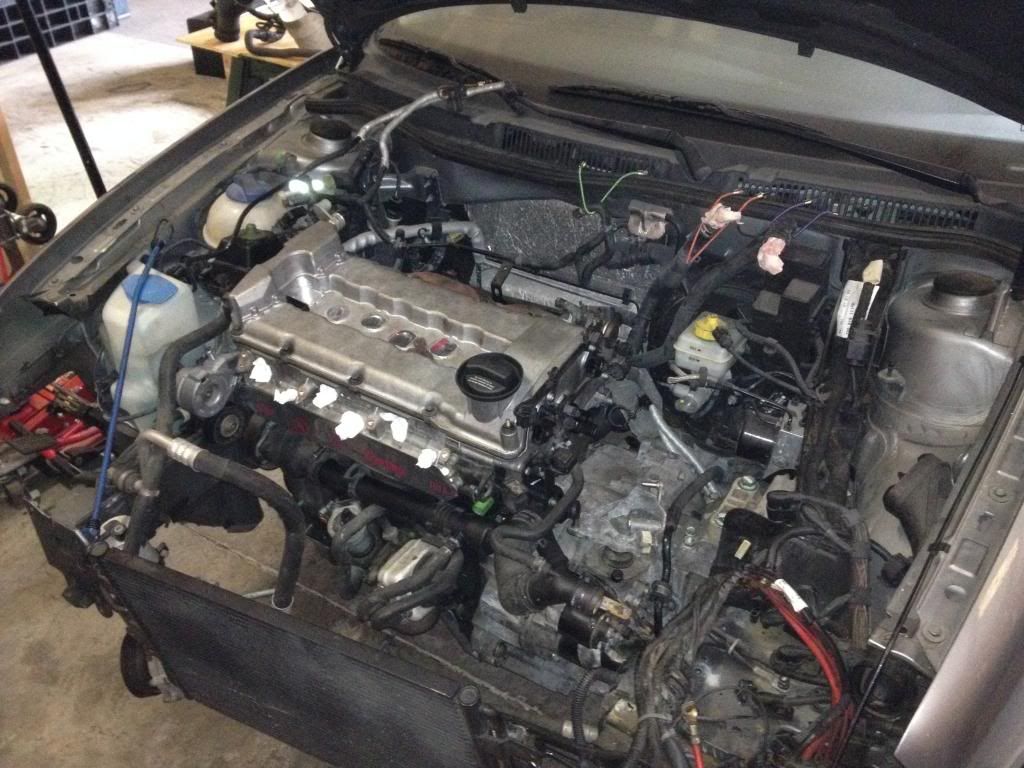

First shot of it back in the car:
...and with the radiator support back in:

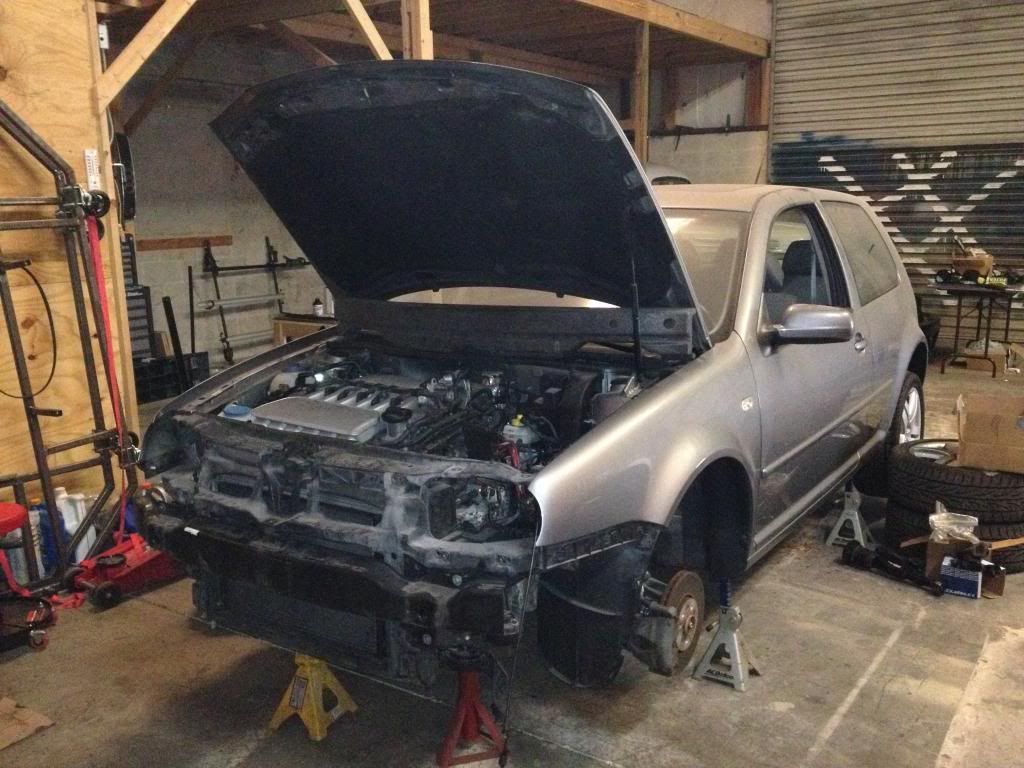

All buttoned up, screaming WASH ME!

Nice. Does the nose have to come off or is it just easier?

Yes and yes... It has to come off so that you can access the intake manifold bolts. But taking it off isn't all that involved and really opens of space in front of the engine, especially when you are doing major work. Similarly, the nose has to come off to replace a valve cover gasket in these cars since the intake manifold has to come off for that operation as well. For something as simple as a valve cover gasket, removing the nose of the car seems a little excessive to me... this car got a new gasket prior to the motor going back in
There is a VW special tool that replaces two of the bolts in the metal bumper and allows you to slide the whole assembly into a "service position" for some of the simpler tasks. I made a "special tool out of really long metric bolts from Home Depot. It works but is somewhat unwieldy, especially with the condenser and radiator in the mix. Probably easier just to remove since the heat exchangers can be supported with jackstands.
