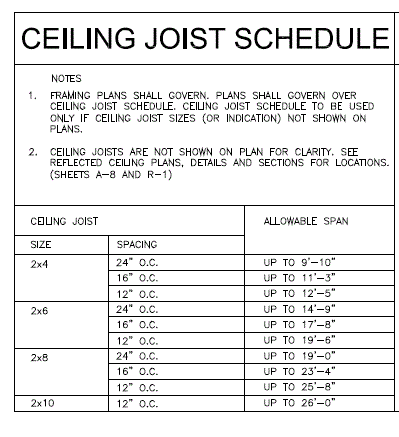

Steve W 12-29-2017 03:12 PM
Use the following schedule below to determine ceiling joist sizing and spacing for hanging a drywall ceiling. This is from the plans of a custom home I'm currently in the process of building. If you tie your ceiling joist midway with a support to the roof joists, you reduce the effective span and can reduce your ceiling joist sizing.
http://forums.pelicanparts.com/uploa...1514588858.GIF
wdfifteen 12-29-2017 07:31 PM
This is very helpful. Thanks!

MBAtarga 12-30-2017 08:17 AM
Originally Posted by peteremsley (Post 9865980)
A simply supported 19'6 span 2x6? No thanks.
Peter - that is with the joists on 12" centers. Not likely an economical choice (material and labor) when compared to using 2 x 8's on 24" centers as an option.
