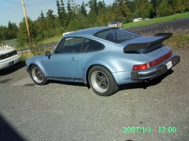

ok so theres some pics of the car and engine,sorry there so lousy...i threw a pic of a cool bike im building in there too...no reason really,its just fun to look at

What makes you think it's a '66 911 ?
Or was that a typo for '76 ?
Do you have the VIN number ?
Could that be a 930 with a carb 3.0 engine ?

that things a wide body i was thinking it was a 66 that someone put a 6 cylinder motor in . i would say its a 86 to 89 . is the radio ant. in the front glass and is the 3rd brake light in the rear glass . the drivers door jam or the drivers side dash should have the vin . do you have a clear photo of the info label . i take back when i told you to sell it for parts fix it !

ok,the rear glass has a third brake light,but theres no vin on the dash or by the smugglers box,the front of the driver side doorjamb has a small plaque with a karmman porsche with a 5 or six digit #.i can take a pic of it.is there any hidden spots for a vin on the car?where the cops check?

ok,i finally got the numbers off the inside front of drivers door jamb. 454478 i dont know if that means much t anyone,could the dealer tell me what year it is?

If I remember correctly, this is a '66 912 with a Karmann body.
962, porsche used 6 digit vin until '68.

I think you have a 912 chassis. I am not positive but I think you do. This wouldn't bother me as I have a 912 chassis with the 901 engine in it. Its the same exact body with less options so it ends up being lighter too. I'd fix it as you can buy everything it needs welded back on pretty cheap. I think you could have it together in a couple weeks.

dave . yes i know that porsche vin # were 6 digits untill 68 . and when i first read this post i was thinking it was a 912 with a 6 cyl. 911 motor . but then looking at the pics that were posted . i'm thinking mid 80's ???? i gave that # 454478 to a frend at porsche NA to check . when he talked with me that evening he did not have time to check yet .but did not think it was the vin # ? i will send him an email and see if he had time to check the vin # .

454478
That is a Karmann 912 coupe body from 1966, (4 cly Type 616/36 engine). Take off the lower dash trim under the ashtray and the serial number should be stamped there also. (Porsche built 912 bodies 1966 serial numbers start with 350xxx).
The floor pans, inner and outer rocker panels, both front and rear inner wheel houses, battery tray, gas tank mount, are typical replacement parts, but the spot to really look at is the rear torsion bar tube to the rear wheel house. That area and the torsion bar itself -if that area is bad - the structure of the whole car would be in question.
If you are cutting pans, trays and rocker panels there isn't a lot holding the car together. Best to have it on a jig bench or it will be twisted when done. All the critical dimensions and reference points are in the Factory work shop manual.
If you choose to work around the car replacing floor panels and other parts one at a time the likelyhood of ending with a twisted body is very high. The previously replaced panels will be your reference points and there is no knowing where they are in relation to the critical measured points.
