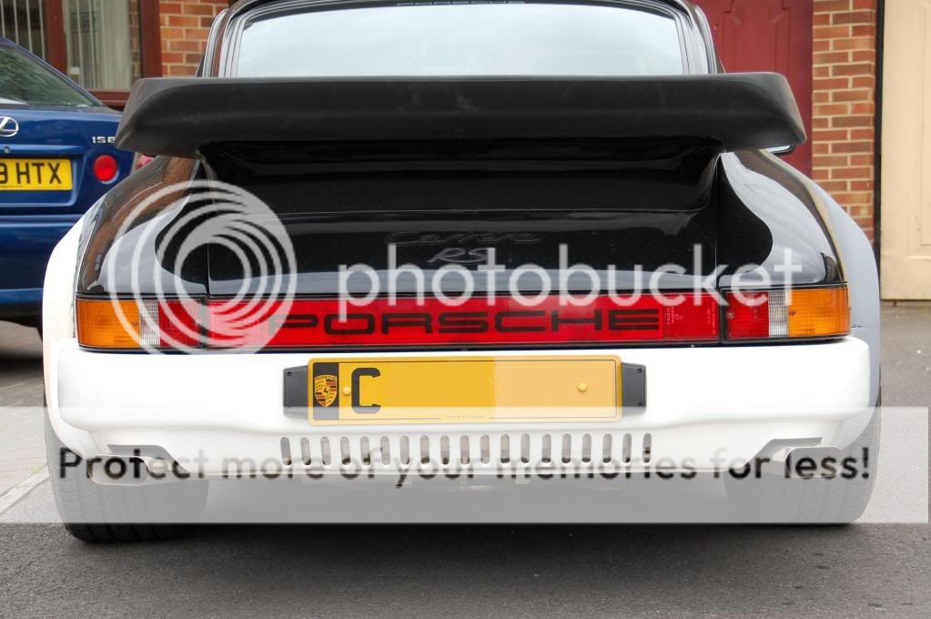

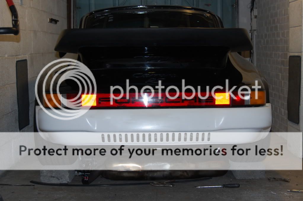

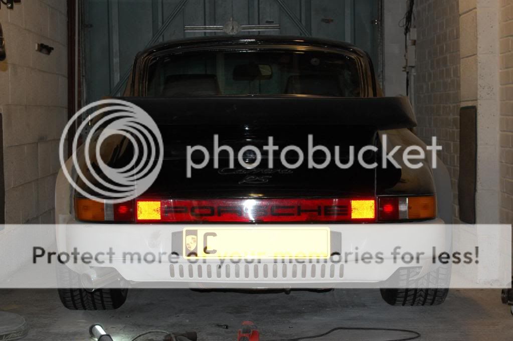

just wanted to show you how my 'clone' RUF Blackbird is coming along. I have extended the rear arches by 1 3/4 inches (a,la Yellowbird) fitted a twin exit TT exhaust, wheels etc.
Below are some before and after pictures. As always, any comments welcome.
Front
Rear with bumper dry run fitted and standard arches.
Rear bumper fitted with arches extended a,la, Yellowbird.
Rear with bumper fitted, arches nearly finished and twin outlet TT stainless exhaust,,,, sounds awesome.

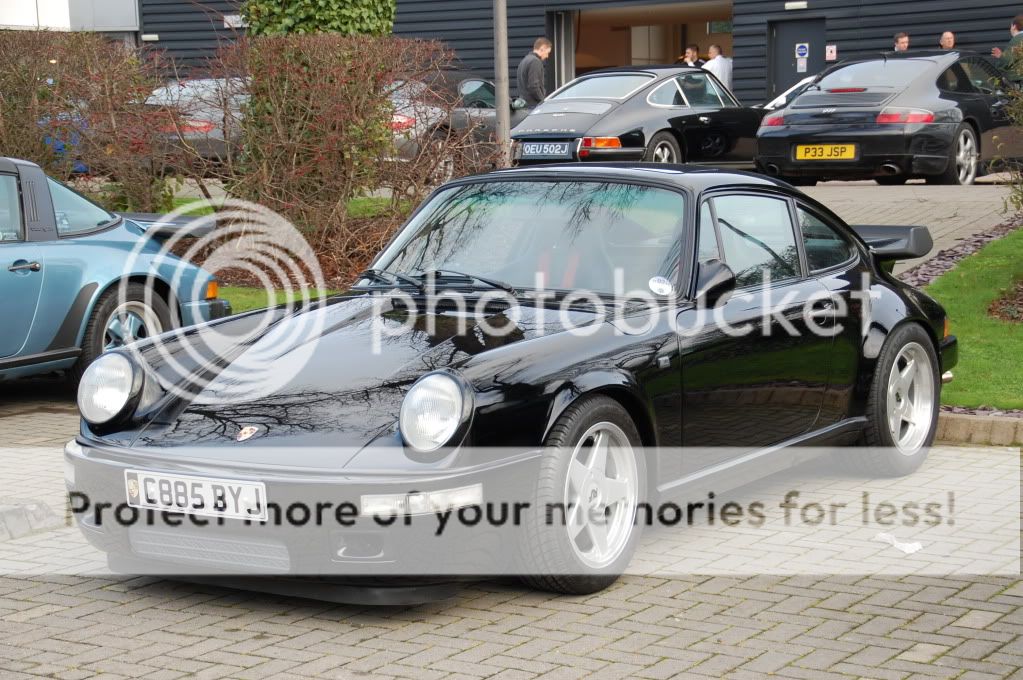

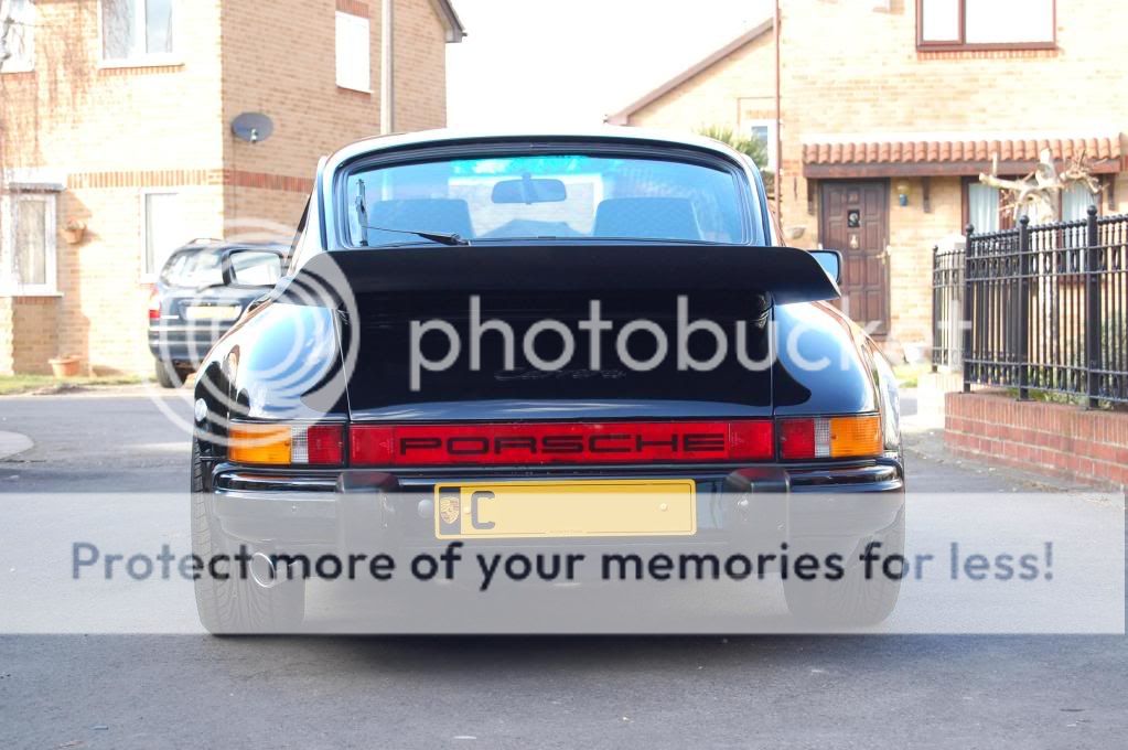

A bit more of an update on my RUF clone 'Blackbird' progress to date. The car is now painted and I have some shots of the work progress.
A picture of it as standard before any mods - looks anorexic doesnt it?
Here is the car with the widened arches - it now measures identical to the Yellowbird. Bumper loosely fitted - without spoiler.
Here are some more pictures of the car now I have sprayed it after the arch extensions and flag mirror delete. At this time the car is not totally finished - no sill covers, RUF mirrors etc.
And one from the rear now the beading and spoiler is fittted. The rear end is now finished.
As always, any feedback greatly recieved.

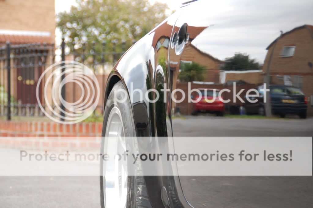

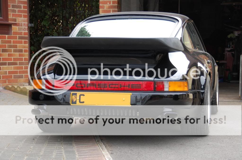

Rear arch extensions.
Hi, thanks for the comments.
When I fitted the rear wheels they were too tight and I wanted to create a car along the lines of the CTR. I dropped plumblines from my arches to the ground the used the CTR spec and noted the CTR is 1 3/4'' wider per side - not as wide as a turbo though. Then my search began.
I found a RUF 'clone' company in Germany who had one set of carbon fibre arch extensions - luckily I grabbed them.
Firstly I had to roll the arches to bring the original lip back on itself and start the widening process. the rolling also kept the original curve but the orifice of the arch had to be larger. This took two days of solid work. Once this had been done i removed the surface paint and primer to metal. I now started to work the arches to suit the extensions. Once this was done the arches were screwed onto the car to check fitment via the already drilled alignment holes.
Then I applied the bonding agent and fitted the arches properly as you only have one chance. Once the bonding cures (very little bonding used due to the almost perfect fit) there is no way the arches can be removed. As I didn't want to use filler I used just a very thin bead of resin to finish to the original body. Final finishing was done via stopper, flatted and then painted.
Would I do it again? well it took a long time but until it was finished I did think 'had I done the right thing'. Now its finished and looks superb it was well worth it.
It now measures exactly the same as the CTR's 'footprint' and body width.
Hope this helps.

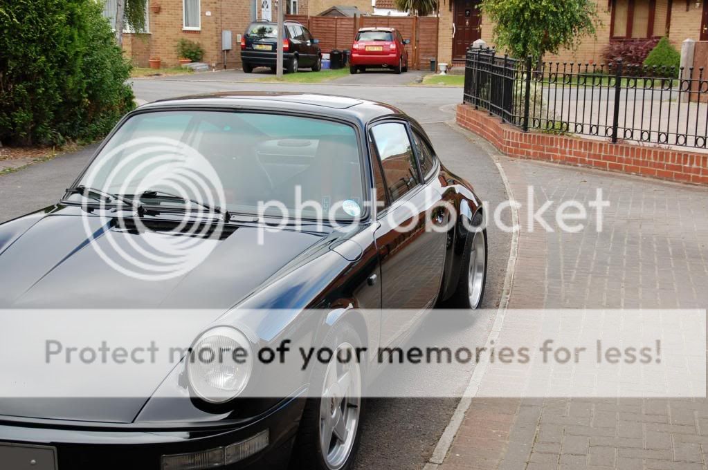

Porsche Crest 'Blackbird' is now finished
Hi all,
just some more pictures now the 'Blackbird' is now totaly finished, Ruf mirrors fitted etc.
Enjoy.
Regards
Jammo.

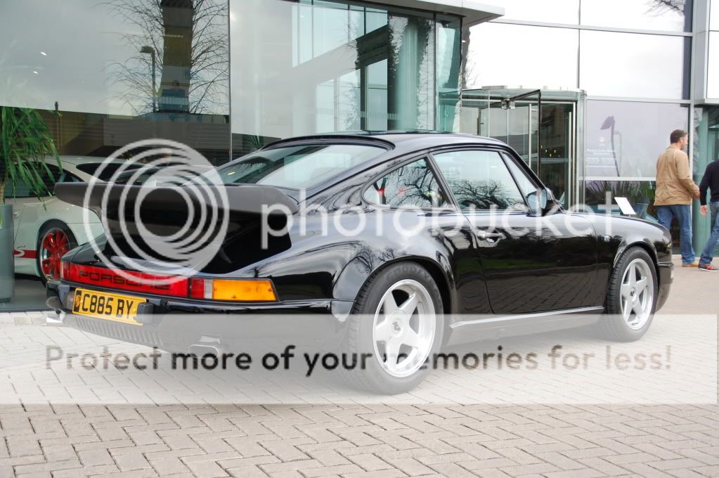

Just a quick update.
The 'blackbird' is now totally finito and this is how it has turned out. The photo's were taken at our local Porsche dealership on a recent open day.
They had some wicked cars there inc the Carrera GT in the background.
After all the work the body turned out as I wanted and not a bad job, certainly got some looks and good comments.
Regards
