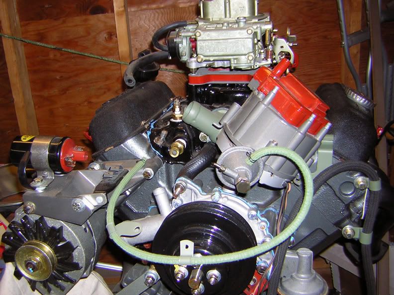

Just finished up the new 4.1 liter for the back of the 356 SC, thought that I'd run a VW engine this time . . .
http://img.photobucket.com/albums/v136/TeamEvil/eng12.jpg
http://img.photobucket.com/albums/v136/TeamEvil/eng9.jpg
http://img.photobucket.com/albums/v136/TeamEvil/eng8.jpg
http://img.photobucket.com/albums/v136/TeamEvil/eng5.jpg
http://img.photobucket.com/albums/v136/TeamEvil/eng1.jpg
Probably not what you meant., but . . . then again . . . I AM Evil.
