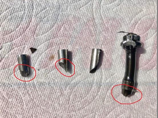

Guys, Thank you for your input. I am interested in hearing some engine solution options. It could be helpful to understand the source of the problem, because that would lead to understanding a potential ownership, which would obviously be helpful with financing the repair.
I wont know any answers to that, until we dismantle the engine. I plan to get it to a reputable engine builder to do that by the end of the month, but it could be December before I know what we find.
In the mean time, here is a picture of the bits that fell out of the oil drain when we drained the oil.

Hi Allan..can you take a close up picture of the brake in the material and bottom of the brake on the longest piece..?Do you see discoloration?
Ivan
http://img.pccreation.net/photos/201809071832577413.JPG

I'm trying to figure out what the smaller bits are. From the pictures they don't appear to have the same finish as the rod bolts. Do they have what appears to be a ground finish to them?
Can you post pictures of the smaller bits from different angles. They appear to be cylindrical pieces. The three pieces look broken on one side and flat on the other.
I'd like to the the "tops and Bottoms" of the cylinders. if possible.

The angled breaks are characteristic of brittle materials twisted off, that is exactly what a piece of chalk will look like if you twist the ends until it breaks in the middle. However, rod bolts aren't near that brittle, note the larger piece that is bent but not fractured. And the other end that is squared off is also puzzling, why would single bolts break in two places?
Are you sure those are ARP? There have been fake arp bolts found in the marketplace made of substandard material. It is hard to tell from the picture, but when I have used arp, they are almost jewel like in finish, not rough at all.

After the busyness of the year end, we were finally able to get into the motor. Through careful disassembly, we were looking for any signs that might give indication or cause for the detonation. In the end there was nothing that was obvious to see, that could have obviously provoked the #6 rod to come through the case.
If there was an over-revved cause, I suspected we might see some impact marks from the valves on the crowns of the pistons - but there were no marks, the valves and the springs are still good. The bearings were all still good, as is to be expected from a motor with 11 500 miles on it.
What is noteworthy is that both ARP conrod bolts broke, and both still have the nuts attached to the bolt ends. One fell out the bottom of the case through the oil drain plug and the other conrod bolt end (with the nut still attached) got impaled into the inside of the case, and produdes a little through the outside.
The other item to note is that; at installation the ARP - 2000 conrod bolts were all a polished silver in color with black ARP nuts. When we disassembled the motor, 8 of the bolts were still silver, but 4 were now black. Not an oil tarnish that could wipe off. You can see the color changes in the photo's below.
All the ARP conrod bolts have been shipped to ARP for analysis. Im hoping to get conclusive remarks from ARP that can lead to a better understanding of the cause for bolt failure.

Stock bolts are black. Hmmmm.

Hello,Will be interesting to hear what the "bolt maker"says. The part that is embedded in the case looks like the nut is partly unscrewed. The broken bits look like they have been cracked for a while? (Bright/dull surfaces). Sorry to read/see such carnage.regards,Michael.
