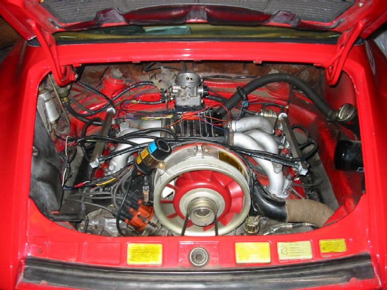

tbitz 02-23-2003 08:59 PM
It's alive, It's alive !!!
My 911SC started and ran for the first time tonight under the new EFI system. The CIS is out and EFI is in. I was surprized how quickly it started and ran. The tuning fun begins now :) Here is a shot of the engine bay with the engine idling. All that is missing is the air filter. I love how clutter free this engine bay is.
I'll be updating my web page within the next couple of days with the latest info.

tbitz 02-25-2003 10:39 AM
Unfortunatly it is still very much winter here in Ottawa, Canada so it's going to be a while before this baby is on th street. I will do as much tuning as possible in the garage. This will only allow me to tune for no load conditions though.
turbo6bar: The ECU runs 'closed loop'. It uses an O2 sensor to montor the exhaust and automatically adjusts the fuel mixture. This should help improve the fuel economy.
As for more Hp, those with a sharp eye will notice the "red top" injectors (32lbs/hr). These are capable of delivering enough fuel for well over 300Hp. Can anyone guess my next project? ;)
