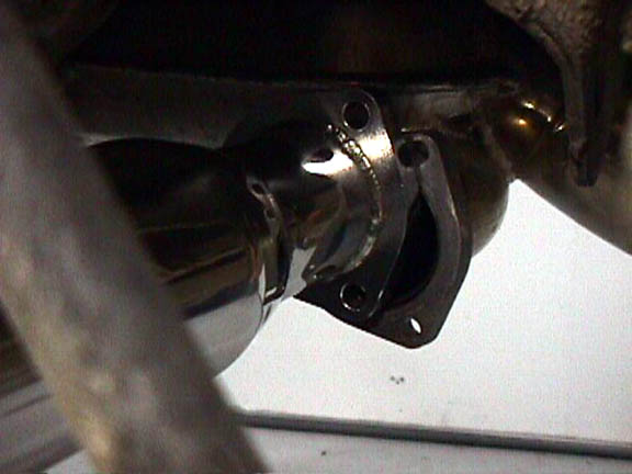

Wavey 03-16-2003 09:19 AM
OK, just tried to install my Fabspeed pre-muffler, and I have exactly the same problem that started this thread.
CK, did you ever get anything worked out with Joe at Fabspeed? I'm going to email him this pic and call him tomorrow morning.
In the meantime, I guess I'll reinstall the original cat. At least all the old hardware is gone and the swap will be much easier when I get a part that fits.
Trying not to be pissed here - but I have limited time to work on my car and it's really agravating when you have a problem like this that totally stops the project.http://forums.pelicanparts.com/uploads/Fabspeedfit.JPG

Haven't heard from Joe again yet, I told him I'd get back to him on Monday with my findings of the jig construction. I got the very simple jig completed using the stock cat as the pattern, both pipes I've received are off almost identical, minor differences are evident, but with the larger bolt holes he provides it's not going to cause enough of a problem to worry about. The problem appears to be at the inlet flange or maybe even the junction of the y connector to the muffler portion. A very small error here will produce large results on the other end. I've found that if I have the inlet flange machined about an 1/8 inch, it will fit perfect, looks like the two inlet pipes are welded at an incorrect angle to me, about an 1/8 inch off, coincidence??? I think not.

Wavey 03-17-2003 06:17 AM
Well, I didn't have to call Joe because I had an e-mail from him first thing this morning. He's offered to pay whatever it costs me to get this fixed locally (which I really don't want to get into), or send another pipe, which I've asked him to do. I just hope the replacement is from a different batch and doesn't have the same problem.
Clay, my pipe appears to be "off" exactly like yours is, and you got two of them the same way.
I think it's very magnanimous of you to fabricate a jig for him, more than I'm willing to do. For $250 I'd just like a pipe that fits and let him work out the problem.
I do have to say that Joe is being a first-rate guy about this, and that's the real measure of the situation. It's OK to make a mistake, it's how you handle it that matters.
