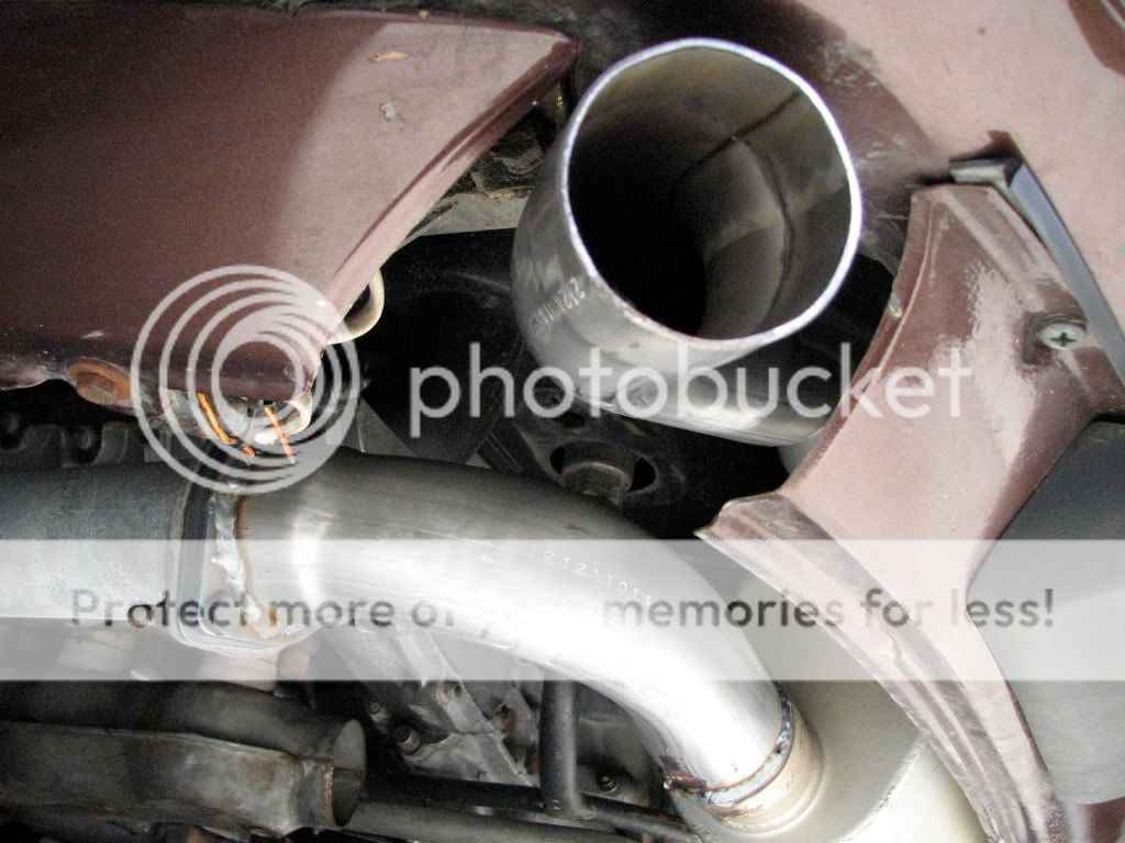

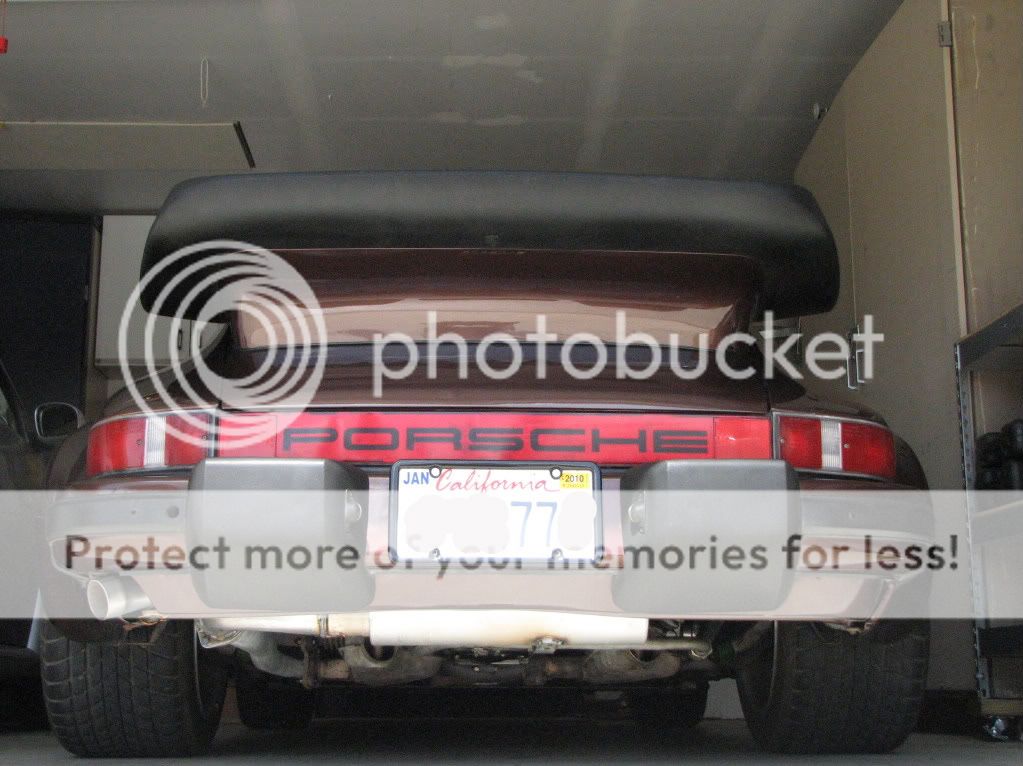

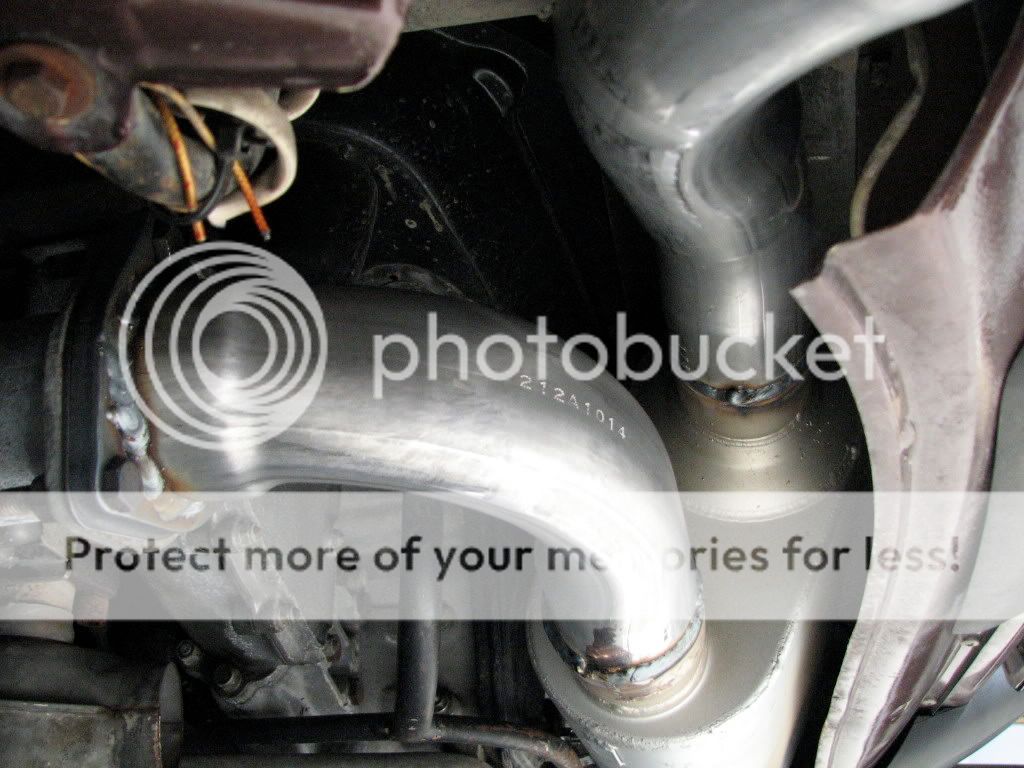

Thanks to all of you for posting about this. I just got mine done today (Flowmaster 52580) after many days of fruitless attempts to locate a guy that was willing to undertake the project. Last week I went to 5 shops and all I got was "come back next week" Next week came and only one of them was honest enough to tell me that he wouldn't do it. All the others told me the same thing: "Too busy, come back next week"
I got so frustrated yesterday I was almost ready to sell the muffler and pay the $720 and get the Monty and get done with it. But today my luck changed! I found this cool shop, Gary's mufflers, owned by the same guy since the 50's. Told him what I had, what I wanted, showed him the picture and he said he could do it! Took him about an hour. His cost $125. Cost for the muffler $95 brand new. The sound? Un-@#*%ing believable! Jack, Randy, Mike911 you all know what I mean...

I have a Dynomax same side 1 in 1 out. It sounds great and performs great. Not too loud at idle or cruising, but rips nicely at full song. I had a buddy who runs a Meineke shop fab up the pipes and I already had a bracket and straps left over from a B& B muffler.
My Dynomax is part number 17676 that is spec'd here on page 3
http://www.dynomax.com/ecat/pdfs/superturbo.pdf
and the install is pretty straightforward for a competent muffler shop. One thing I recommend is you politely suggest to your muffler shop guy that he focus on making the pipe from the muffler to the cat/cat bypass as simple as possible. The alignment between the cat and the muffler inlet is a bit offset and makes for some tight bends that are hard to make. So the guy should position the muffler so it looks good, but also makes his bending work not so troublesome.

Looks similar to what I had done with my Flo-Pro.
1 in1out. I love the sound. nice and burbly at idle, burps between gears, and screams flat out.
