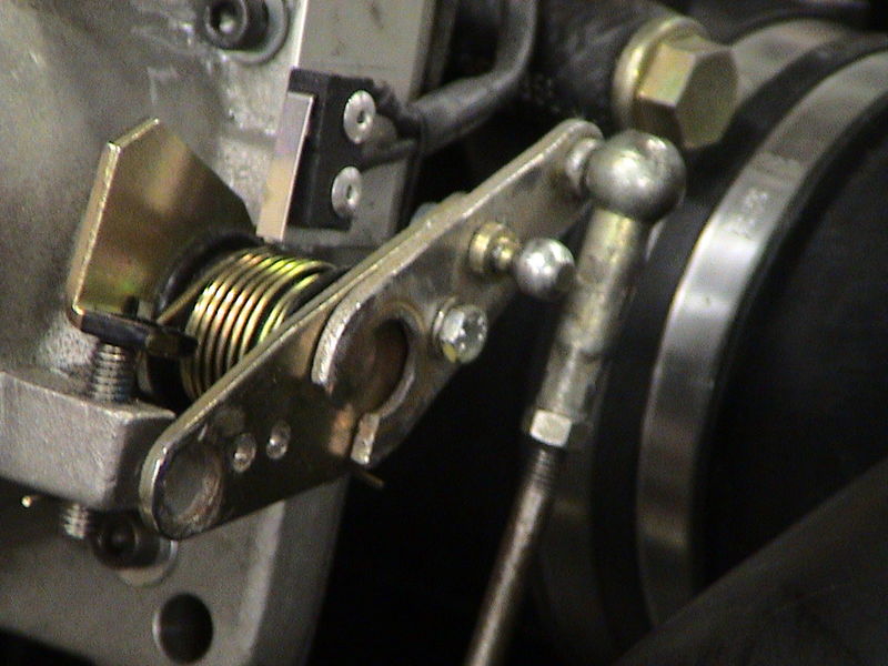

Originally Posted by faverymi View Post
http://forums.pelicanparts.com/porsche-911-technical-forum/995566-sc-964-throttle-linkage.html#post10025968
Forth post
Here's the link and the pic SC and 964 Throttle Linkage
This is exactly how I did mine, bomb proof! Pic credit to fellow Pelican (safe)
One thing to be advised about is the bushings in the engine mounted belcrank console wear quite a bit over the years,
so I would suggest inspecting them and replacing them if worn. They are available from our host.

Old 03-17-2019, 11:15 AM
175K911's Avatar
Join Date: Sep 2007
Location: Wheaton, IL (Chicago 'burbs)
Posts: 3,028
That's exactly what I'm looking for, thanks!!
