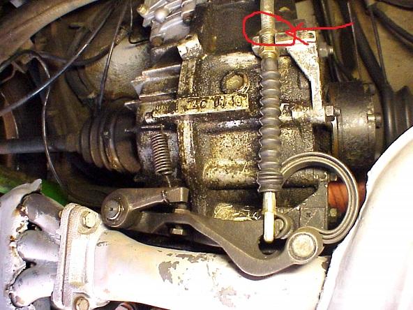

for the shaking your transmission mounts most likely bad or loose.Then make sure the engine and trans.is tight together!!
Put a wrench on it 3x 15mm nut should be there and one on starter allen head nut 8mm.
For the release ,loosen the clutch cable on the bracket number 15 open wrench about 1 turn on the further nut from engine...
ivan
this nut......

Was the flywheel replaced? New clutch cable?

Besides incorrect adjustment, there were a couple of other things contributing to takeoff judder in my 84.
Clutch cable was very dry and grease had become sticky. Replaced.
Throttle pedal bushings were shot. (Yes throttle) This allowed a weird little inertial resonance to happen in the linkage. New bushings were the cure.

Why was a new flywheel refurbished? How did they "lose" the clutch on a test drive? What brand clutch kit was used? Release forks crack, did they look at it? New clutch cable?
