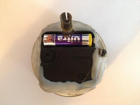

I posted a detailed repair of the 2 capacitors in the SC clocks here. If the 87 clock is similar, that might do it. My fix has been working perfectly for a few years now.
911SC Clock Repair with annotated photos
Keeper of the 1983 911SC Cabriolet Registry (http://911sccabrioletregist.freeforums.net)
