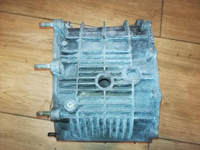

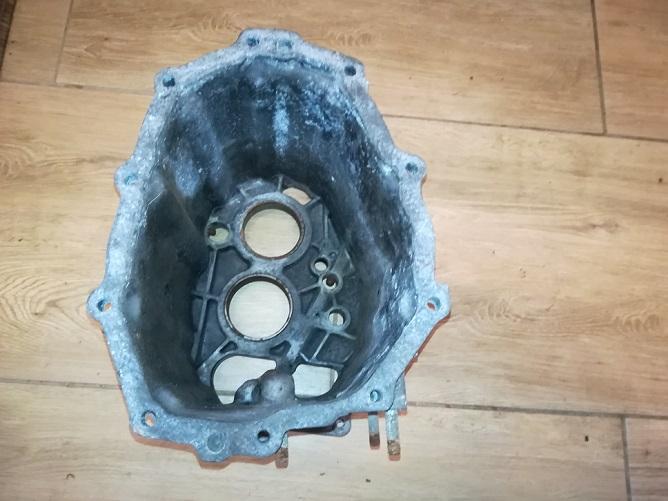

geronimo..the trany case if the bearings are loose in it can be done machine shop..there are plenty in LA...Even Marc Brixen can guide you to it..those quotes are very steep......take your time before you agree to the repairs...i have one case ...here for a long time if you end up needing one, it is yours free ,just shipping from Europe to USA will be up to you;-)
