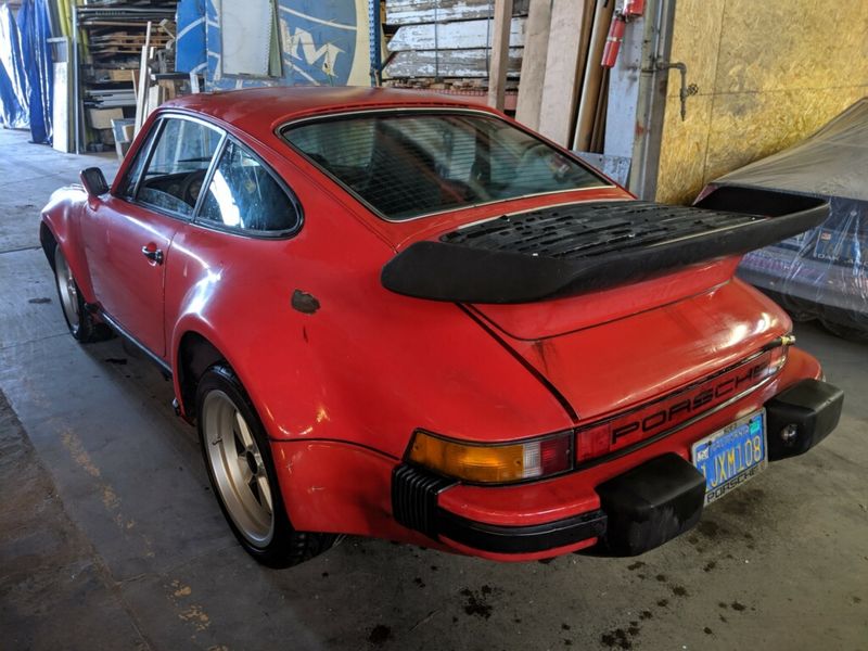

Hello!
You may remember me from such threads as "Born in '75. Me and my 'new' 911s" or Being Tall in Today's Short World
Well guess who's out here resurrecting another beat midyear? This guy!

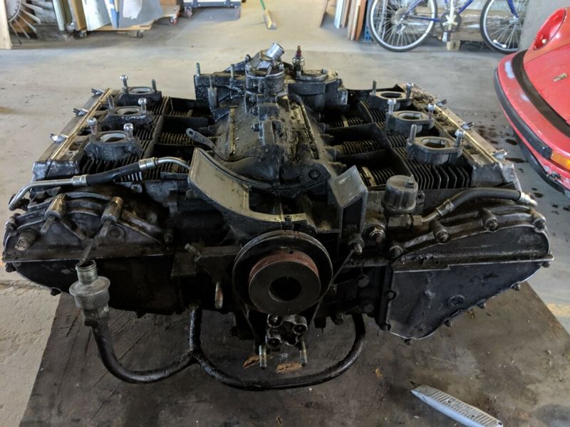

Follow me as I turn this:
Into this (Photo courtesy BaT)

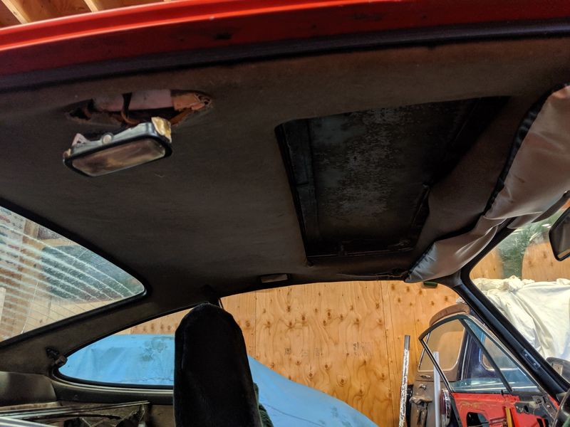

Great project - how are you planning to delete the sunroof - cut the a/b/c pillars, unfold the rain gutters, or lap/butt weld a non sunroof section in?
I also have a non-sunroof clip that I would like to use to do a sunroof delete. Thanks!

I'll go into detail in a future video of how we (and by "we" I mean me and my metal guy) will approach this. I make no claims of being a metal worker, which is why I've enlisted a local talent to assist with the roof and body work.
