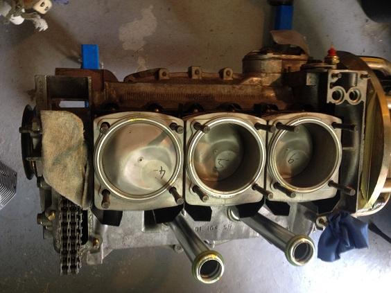

Sealing surfaces between heads and cylinders get "worn" regardless of whether the cylinders have the CE ring seal or not. It's the studs allowing the joint to shuffle that causes the wear and the CE ring seal does nothing to prevent it.
3.2 Carrera cylinders do indeed NOT have the CE ring and that's not necessarily a bad thing. They seem to seal better and are also more desirable. Typically the desire is on the used parts side of things, because without the seal ring groove, they are the better choice to have bored and re-plated for the 98mm bore (3.0 to 3.2 or 3.2 to 3.4) many people desire.
The lack of the CE ring groove provides a thicker area at the very top of the cylinder when the cylinder is bored larger. The belief is, the remaining thickness after a CE-ringed cylinder is bored larger is too thin, which can compromise the cylinder strength. I've seen these CE ring cylinders bored larger and it is quite thin there, and the plating chipped off which required me to have one of the cylinders re-re-replated during a rebuild
My set of cylinders are pictured here and sorry there's not a good picture in the group showing how thin the cylinder wall is Core Mahle Nikasil Cyls- 98mm SC style
I'd be curious to know what the seller's basis is for needing head studs soon. I'd have to assume signs of oil leakage at the head-cylinder location? Because broken head studs are easy to detect just by looking in the valve covers. Either a piece of broken stud (with the nut & washer still on) it is sitting in there, or there's no nut at all because someone took it out and figured, ah no big deal three studs are still holding it together Otherwise you can't see the lower studs anywhere else on the engine to assess their condition.
A 3.2's lower studs are black epoxy coated and all it takes is some compromised coating to allow rust to start, which will eventually lead to a broken stud. Here's how one of my studs greeted me when I was disassembling it for bad valve guides
your opinion on head studs
It's not practical to replace the stud in-place without some teardown because you can't get at the end of the stud with a tool to extract it. Nor do the studs want to release from the engine case due to the original installation which used thread locking compound. You also can't reset the new stud to the desired depth all that easily. Stud depth is important because of the goofy barrel nuts Porsche chose to use. Incidentally that stud depth issue can be avoided by using a different type of nut (flanged hex nut) but that's another discussion for another time. Basically you want to take off the heads so you know what you're dealing with. Like the guys said, you want to get a look at the head surface and the cylinder surface to see what amount of shuffling damage they do/don't have.
Simplest approach here is engine removal and remove the heads and cam housing as a single unit (leave all 3 heads attached to cam housing) which then leaves you with the exposed cylinders. Slide the cylinders up just a bit to leave the piston rings undisturbed so you can get at the wrist pin circlips. Remove a circlip (easier said than done) to allow the pin to come out and then you can leave the pistons in the cylinders and not disturb the rings. The rings are quite fragile and easy to break, so that's why you don't want to bother them. However, this can also be viewed as short-sighted because leaving them in the cylinders does not allow you to get a look at the rings to see if any are already broken. Nor can you check the ring grooves in the pistons for wear beyond spec. This is where the slippery slope can start to rear its ugly head.
Anyhow, once you get the pistons off the connecting rods, then you have the easiest access to the studs for any that need replacing. The reason you need the cylinders out of the way is because often a stud will be broken way down near the engine case. It never breaks at the top where the nut is installed. Obviously with the heads and cylinders installed on the engine, there's no way for you to get allllllll the way down to the broken stud to extract it.
