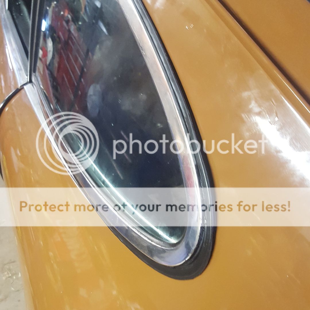

Quarter Window Seals Too Tight
My old quarter window seals were brittle and cracking so I bought new (Uro).
Passenger side went in OK, a little difficulty but acceptable.
Drivers side not so much. So tight the window won't go in.
Seal fully seated in the frame.
Would Porsche seals fit better?
[IMG][/IMG]
I have the exact same problem.

For what it's worth I only use Porsche seals and have never had that problem.

I had the same problem. URO offered to take them back and replace with seals that fit.

lsf911 is correct, we scrapped our entire inventory of the old version Vent Window Seals late in 2018, and ran our first batch of new seals with the corrected durometer rubber about three months ago. We have the new softer seals in stock in our warehouse, which means they're now available through Pelican. The new softer version has the four digit code "7082" or higher on the label.
If anyone purchased the old version of these Vent Window Seals and had problems, please contact us via PM or "sales at uro parts dot com" with your purchase details (purchase date, retailer, order number, name & shipping address) and we'll be happy to get you replacements.
Please PM us your purchase details Artfrombama, and we'll get you a pair of the new version. lsf911, PM incoming.

Hi Artfrombama, just checked into our quarter glass seals 901 543 901 20 and 901 543 902 20. We sell about 450 of each side annually, and the material and firmness of our current stock matches OEM. We did make a minor cosmetic change to them about two years ago in response to feedback (there was a thin flap that was a bit wavey when it should have been perfect straight), but yours is the first complaint we've received about them not fitting. Others may very well have experienced the same thing, but unfortunately didn't let us know, so thank you for the feedback.
We just compared our seals to OEM, and see several areas that could be changed to improve the fit. Our engineers will review them more closely over the next couple weeks, and it's quite possible we'll redesign these seals. Sorry the process takes so long - we'll update as we know more.

I will purchase the Porsche seals and report my results (with photos) on this thread. I've bought many Uro parts and installed them on my 911 with no problem whatsoever but I believe these are defective and cannot and will not recommend URO #90154390120 or #90154390220 to anyone.
EDIT-Drew with URO product support is very accommodating and offered me URO merchandise to compensate. Up until this problem I had no issues with URO parts and believe this company strives to make the customer happy.
