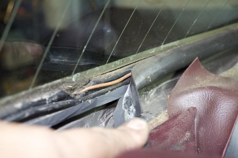

redridge 04-22-2014 06:35 PM
I did this last fall... the gasket will stay on once all of it is on the glass. The tension of the seal will keep it on the glass... I believe the tape was used as a starter to keep the seal on as it is walked on to the glass, more tape were put on further down the glass as more of the seal are attached. No adhesives or sealant were used... however dum dum was used on the frame.

rich 04-22-2014 07:18 PM
The seal I have has two inner channels where it attaches to the glass. Does anyone know why? And which channel should I use when placing it around the glass? Inner or outer?
Weird gasket.
Series900 04-23-2014 05:58 AM
Wires on the inner, glass on outer.
rich 04-23-2014 06:05 AM
Got! That's what I needed to understand. Thank you.
redridge 04-23-2014 07:14 AM
here's a pic...
http://i169.photobucket.com/albums/u...ps72d8ac5d.jpg
