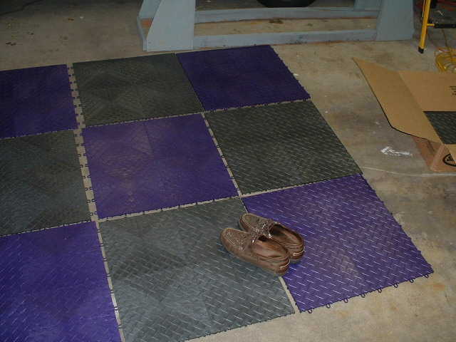

The Racedeck tile came packed in 4x4 squares (24 inch by 24 inch). I had thought it would be loose 12 inches tiles.
But I kinda like the 4X4 tiles. What do you think - lay it in 4X4 or go back to 1x1? Picture shows 4x4 or 24x24 squares.

These will last much longer than an Epoxy floor - 15 years min vs five or so. if you get a really large spill like dump 13 quarts of oil (who ever does that?) just pop out a section of tile, drag it out in the drive and clean up. For normal cleaning any degrearser will do.
Here is a bunch of shots of the install this weekend. 500 ft or so.

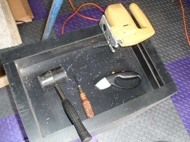

Simple tools needed. saber saw to cut tile, rubber mallet to seat them and screw driver for wedging work.
http://forums.pelicanparts.com/uploads/Floor_tools.JPG

Not much prep required for this stuff. It is fully suspended so you do not glue down the tile.

With the suspension system you need to leave about 1/4 in. all around for thermal expansion. The directions said as much as 3/8 if installing in the cold. It may be WI but it wasn't cold today.
http://forums.pelicanparts.com/uploads/Floor_edge.JPG
Cutting and fitting is very easy but the tile is single directional so too many beers and you will spoil a tile or two.
