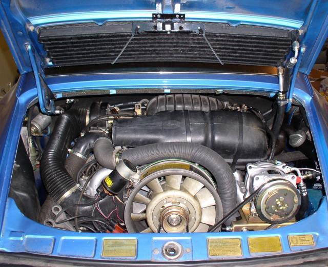

We had a 2nd 911 A/C tech session last Saturday and I finally got around to pumping down and filling the resurrected A/C system on my '76. After locating a leak (flare fitting joint at expansion valve) and replacing a defective high pressure fitting Schraeder valve on the compressor we did the deed. We also converted a Turbo stock system over to R-134a and boosted the fill and added some compressor oil to a Carrera that had already been converted. In the '76 we obtained 50 F vent temp idling in driveway and "putting" around town at 30 mph with 90 F ambient air temp and full sun load. Out at crusing speed (~75 mph) it will freeze one out; I had to increase the temp and turn down the blower. 90 F ambient, ~3-4% grade, 3-4K rpm, 60-65 mph with A/C on full, oil temperature rose to 210 F and stabilized with trombone cooler. Engine has 11 blade fan, new Sanden compressor, NOS engine deck lid condenser, new barrier hoses, new receiver/drier from NAPA, new expansion valve, flushed and cleaned evaporator, better sealing of original blower and I added a 88 CFM muffin fan (12v and .45 amp for $6) behind passenger footwell floorboard to boost air flow across evaporator. Filled the system with ~24 oz. of R-134a; monitered pressures while filling and used a small 110 VAC window box fan to blow air over condenser to obtain better high side pressures while filling. Also have a 300 CFM muffin fan (12v and 2.45 amps for $19.00) to mount on the decklid condenser; there is just enough space to squeeze it in. I will either relay it to come on with the compressor clutch or add a temperature switch on the condenser. Took some digital pictures; I'll try and get them uploaded. Making 911 popcicles in Los Alamos :D Jim

View of engine with new A/C system installed. Griffith's kit no.1 , NOS evaporator and new barrier hoses with bead lock fittings I made myself. Note over pressure compressor clutch cutout switch on high pressure line near oil filter.
Checking for leaks and evacuating the system with my friends "Yellow Jacket" vacuum pump and R-134a refrigeration gage set (thanks Dave!). Later during system charging with R-134a the engine hatch was closed.
