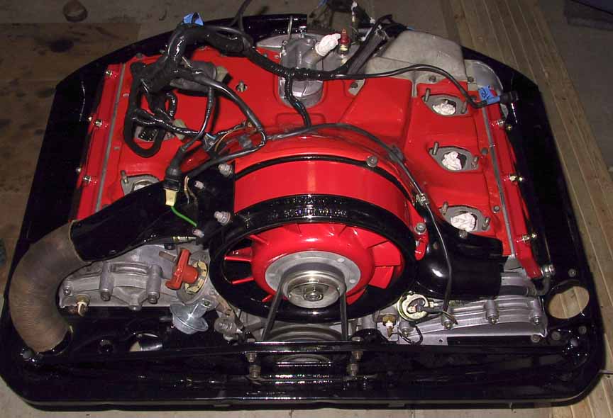

Hey Guys, I'm spending the weekend cleaning and painting my engine tin and shroud on my 3.0. The shroud is a little faded and tired, want to repaint the red.
Whats the shade of red it should be? The faded color looks like it has a lot of orange in it.
Thanks!

MotoSook 07-12-2003 06:19 PM
Mine was cracked and looked too crappy to buff...so I got a can of Chevy Orange Red. It is pretty close, but then I am a bit color blind :(
Should work. I epoxied the cracks and applied a thin coat around areas where the gelcoat looked especially bad.
How's it look?
http://forums.pelicanparts.com/uploads/clean motor.JPG

RoninLB 07-12-2003 06:26 PM
Originally posted by Souk
How's it look?
great contrast with the black.. the pic looks like a "clean" job..

jriera 07-13-2003 05:47 AM
As part of my engine drop to fix oil and fuel leaks and thanks to Ron (RoninLB) patience, instructions and guidance I went from this old, tired looking, leaking 2.4 (CIS) engine:
http://forums.pelicanparts.com/uploa...ine_old_jr.jpg
to this old, but nice looking (and hopefuly not leaking) 2.4 engine:
http://forums.pelicanparts.com/uploa...ine_new_jr.jpg
'Magic' red paint formula plus black POR-15, some (a lot of) sanding and patience, plus Ron support did the trick (I think), I must be the #3 that Ron mention in a previous post in this thread.
Ron, I will take some better pictures later for your 'collection'. Thanks.
