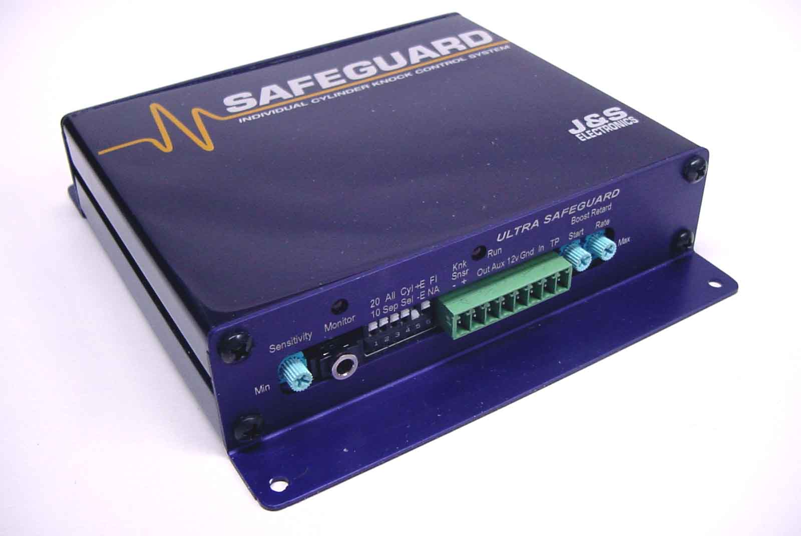

May I ask for people's experiences with the aftermarket knock control devices like the J&S Safeguard http://www.jandssafeguard.com/ device mentioned earlier in this thread?
I recall one 930 owner saying he had one and it worked well - this was in a thread several months ago. I've also read opinions that external knock sensors don't work well on air-cooled 911 motors, but the factory uses one on the 964 engine. Surely the race engine gurus here must have had some experience with these devices?
What I am especially wondering about is if the J&S device operates independently of whatever engine management system you have, so you could piggy-back it on top of a Motronic.

Wayne 962 01-15-2004 03:33 PM
I can't see how you would be able to make that work, considering that the Motronic computer controls all aspects of ignition timing.

TimT 01-15-2004 04:24 PM
I dont have hands on experience with the J&S unit but am familiar with someone that has it on a highly modifed 930. The car has Haltech E6K engine management and waste spark ignition.
The J&S intercepts the signal from the ecu to the coils, if no knock is present, no adjustment is made. If knock is detected, the timing is adjusted.

jyl 01-15-2004 04:48 PM
I called J&S Safeguard and spoke to the guy briefly. He said their "Universal" units works on a '80s Porsche w/ stock Motronic.
The universal unit is pictured at:
http://www.jandssafeguard.com/images/UniversalApp.jpg
And installation instructions are here:
http://www.jandssafeguard.com/UniInstall.html
He said one location for the knock sensor is under the fuel rail. The Universal unit comes with a GM knock sensor for $495, a Bosch knock sensor costs an additional $50.
I don't have any personal experience with this device - all I'm doing is searching and reading on the web - but it looks really interesting.
