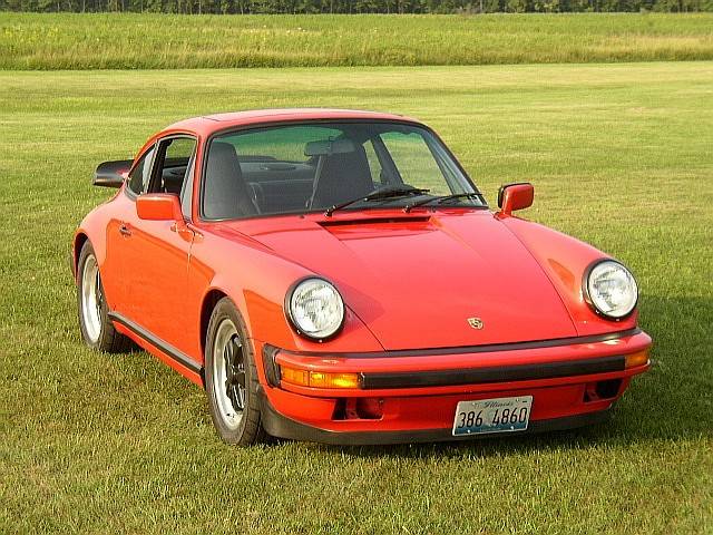

Some Pictures of My Install......
Some of the stuff I used. Use 5 pin relays (grey one) if you only want to install two of them. I installed four 4 pin relays (black relay). Circuit breaker is 25A.
I didn't want to remove the old wiring in case I ever had to reinstall the H5. So I removed plastic H5 connector from wiring and shot some dielectric grease on them before heatshrink protecting them.
Pulled all my wire thru the PVC sheathing and routed it into the headlight bucket. First pic is the wiring from the fuse panel to the relays, which does not actually go into the headlight bucket.
Here's how I kept the old wiring in place and fed the new wires alongside
I put the headlight bucket grommets onto a 1/2" drive extension and warmed 'em up to stretch them out and make it easier to feed the two groups of wire through.
Kevin L
Present: '86 Carrera, '79 911SC widebody conversion rolling racecar shell
Past: '87 Carrera
Old 01-17-2004, 08:40 AM
KTL KTL is offline
Schleprock
KTL's Avatar
Join Date: Sep 2000
Location: Frankfort IL USA
Posts: 15,729
Send a message via Yahoo to KTL
Added a new ground location in the front passenger corner of the tub. The existing ground location near the battery is already pretty busy with other ground connections.
Routed all the wiring in the same location where all the other wiring is routed. Underneath the front edge of the trunk, over to the front passenger corner. I thought it'd be the best location for my relays since that's where my new ground location is place. Only thing I don't like is the long run of the power leads. The power leads have to go from the battery, across the front, and down to the relays.
Mounted the relays on the front of the tub as well. Preliminary mounting of relays with tape. Drilled and mounted with nuts & bolts later.
Finished installation:
I don't really like the location of the circuit breakers (yellow and red chunky things), but they do need to be somewhat accessible in case they're tripped and need to be reset. Everything else appears almost like a factory installation, so nothing really gets in the way of other stuff or clutters up the trunk. Overall it turned out pretty nice. Kind of a compromise as far as having to locate things in strange places. But at least it's not hacked together. I took my time and tried to make it the best quality installation I could do.
