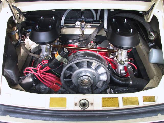

engine !
Hello
this is my engine a 2.7 liter,
my winter project is to convert to RS spec. with new pistons and S cams... and recurve the distributor or finding a new RS dizzy...
