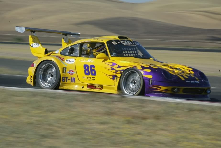

Rear Quarter cutoof question
Can someone please send me a photo showing cutoff lines for removing the rear quarters from my '77 chassis with turbo flares? email it to: drummer323@hotmail.com

I have some pictures of my car below without the bodywork. I will load a few on the computer and email them to you when I get home.

Super, thank you. It will help knowing where to cut so that I have enough left to have my new ones put on. John.

Thanks Tom ..we never really gave real numbers on the car but since it is on the shelf here they are...712 hp and 655 lb ft of torque. 2,140 lbs. Won just about every race ever entered, and if it didn't take first overall it always set the fastest lap of the race trying.
John,
Make sure you have your body work as not all fit the same. Mine had it's own tail light buckets so I cut out the factory stuff. Some rear body panels do not have this provision so no matter what you see on my car make sure you have the bodywork you are going to actually use on hand so you can lay it up to the car for reference. Also, if you are going to make a mistake make it on the car toward the side of caution..you can always trim away more metal for the proper fit. Take your time don't put yourself in a situation where you took to much off the car and now need to start patching pieces to make it fit.
I assume this is a race car..is it ?

Oh no..the 935 has a 962 motor....the 86 car has a 3.6 twin turbo motor . I started with an original 1994 3.6 turbo motor . Tial Industries with S.Car.Go Racing built all the exhaust, turbos, waste gates and intercooler. Rich at Jerry Woods set up the Motec ECU . The motor in the 935 is an andial built motor based on a 962 with Kuglefisher Mech injection and both air to air and water to air intercoolers.
