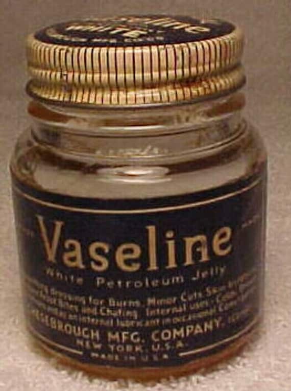

On all "O" rings I use Vaseline. On the collapsible oil return tubes it lets the parts slide around nicely. The melting point of Vaseline is about 100*f with a flash point of about 400*f so it lets the "O" rings move or settle in during assembly then melts once the engine warms up. The "O" rings will do a final snug and seat into position.
Use it on the lips of engine seals (Knock on wood..never had a leak) and slathered on the gears inside oil pumps (instant priming/oil pressure on first starts) too.
