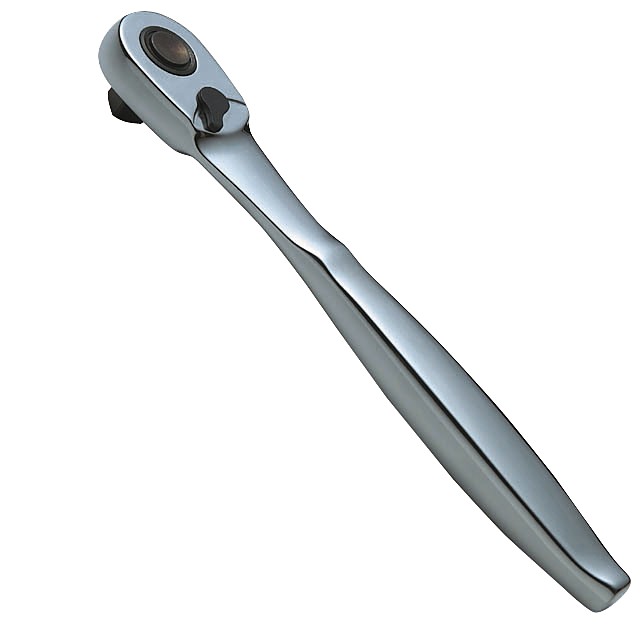

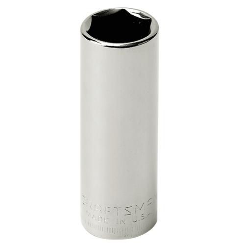

No need to remove the seat in any year 3.2 (unless you have some fixed racing seat) The later cars with the electric seats have less vertical clearance because of the motors, but it's still doable with the right socket. Slide the seat all the way back and upwards for electric seats. Use any standard 10mm deep socket and a standard ratchet wrench to remove the 4 nuts. Almost all deep sockets are 2" long, exactly the length tall enough to clear the DME case, but still be short enough to clear the seat motors.
http://s7.sears.com/is/image/Sears/0...sm=0.9,0.5,0,0
