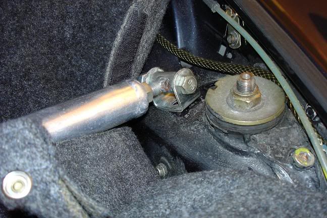

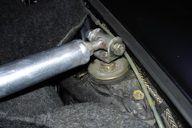

I have recently bought a 'Sparco' strut brace from ebay and was wondering where to fit it.
Does it go on top of the towers like this:
The problem with fitting it like this is that the clamp holes do not fit onto the towers.
Or like this:
I asume that in order to get the rigidity required this fitting would be too high up and away from the towers

I would say on top of the tower, not the strut.

I would say definetly on top of the tower, not thr strut, however im not sure what bolt, front or rears.

We concur with the opinion that you DO NOT want to connect to the top of the shock/strut. IF POSSIBLE, can you add a piece of metal (like a small plate) to each end which will attach to at least 2 of the strut tower (hex head) bolts on each side?
My belief is that if you attach to only one of those hex bolts on each tower, under load your strut will tend to rotate away from the strut brace, and that would NOT BE GOOD.

just as I thought - thanks for the advice.
It seems odd that the bracket only fits to one bolt (normally they are 2 or 3 bolts)
I'll see if I can get a different bracket to use.

The elephant racing brace only uses one bolt and doesn't require that an alignment is done. If you remove two bolts then you must do an alignment.

My strut brace mounts on the two rear tower bolts, yours catching 1 rear bolt each side should be fine, do not mount on top of strut!!
