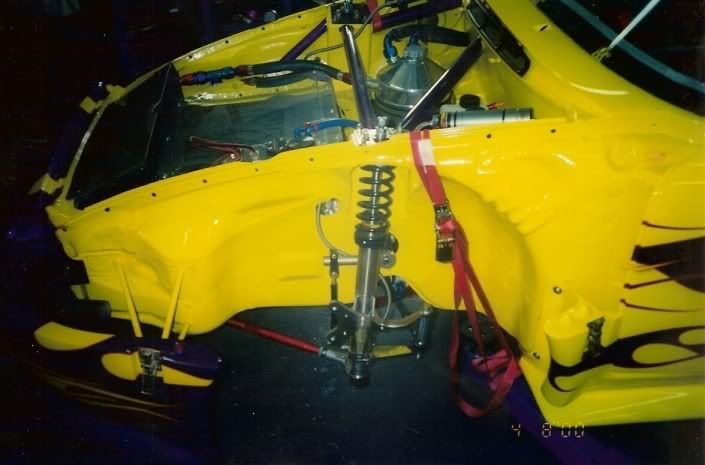

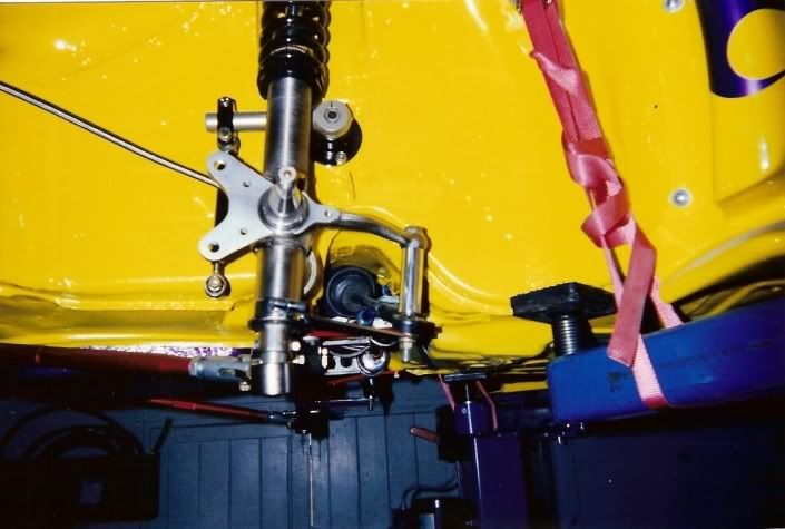

Chuck Moreland 05-18-2006 09:52 AM
That's not the steering arm. That's an extra support to strengthen due to the extra leverage introduced by a hella long bump steer spacer. Sorta like having two steering arms, with the tie rod end between them.
VZ935 05-18-2006 10:03 AM
It works though.. this car handled very well and since you guys seem to be Bay Area people last time out a Thunderhill in 2001 or 2002 it did a sub 1:50 running the Eagles Nest.

Tyson Schmidt 05-18-2006 11:55 AM
It's a "bi-plane" steering arm. LOL!
No doubt it works. Beautiful car BTW.

Jeroen 05-18-2006 03:09 PM
Originally posted by Tyson Schmidt
Looks like custom front struts as well. Looks like someone already thought about bump-steer, since the strut has the steering arm mounted very low. Well below the spindle.
is what we see in the pic the actual steering arm, or is it an extra tab below the stock steering arm that mounts the rod-end in double sheer?
[edit]
never mind, I hadn't seen the new pics yet...
[/edit]
Jeroen 05-18-2006 03:16 PM
still a question though...
the pics are a bit vague, but is that bottom arm mounted with a clamp construction?
Is that so you can still move it for adjustment?

VZ935 05-21-2006 12:00 AM
Yes .. you can move it up and down on the strut .
