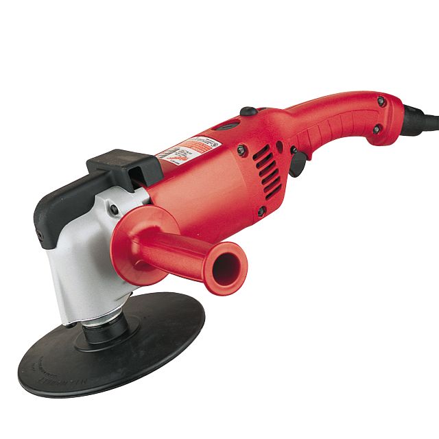

911S Targa 06-15-2006 12:25 PM
I went all out and bought a Milwaukee 11 amp Polisher a few years back. Gets the job done quick, right, with ease. I paid $199.99 for it, but for me, it was well worth it. I did this professionally in a paint shop, and detail shop of a auto dealer for a few years.
http://s7.sears.com/is/image/Sears/00927796000
You can use both a 6in, and 10 pad, and get the same results. The 10in just covers more area when your on the hood, sides etc. For the small, tight spots, use a cloth and a your fingers, that way your not burning your rubber moldings, or tearing up your pads.(yes, you CAN burn your rubber using a foam pad). You should get one that also has a speed adjuster. That does tend to matter with what products your using.
BUT, the first thing to do, if you have never used a polisher, is to practice on an old car, or something other then your pride and joy, so you can get use to the polisher in your hand. You will need to learn how to and not to apply pressure to the area your working.You can, and will burn your paint right off if you apply to much, and you will do double the work if you don't use enough pressure. Its really not a hard thing to learn, and use, and once you master it, you will kick your self in the butt for all the years of hand waxing you've done.
