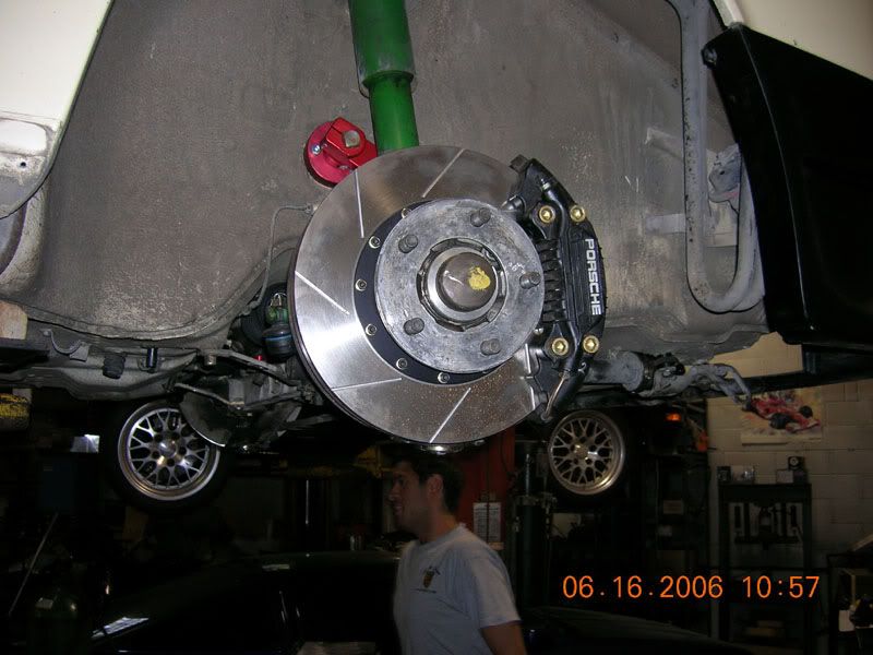

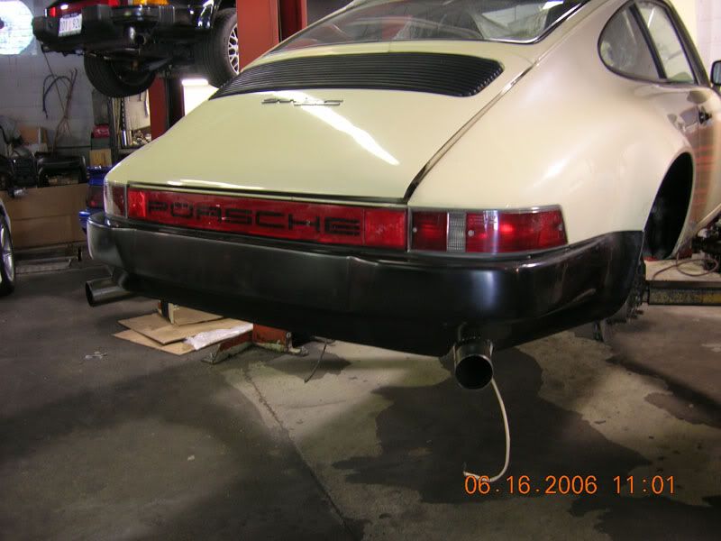

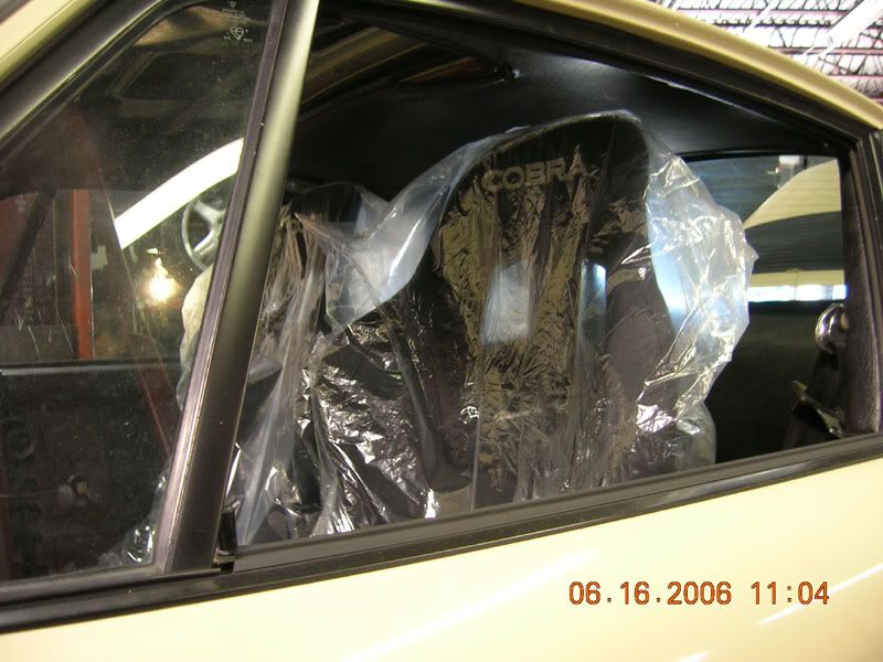

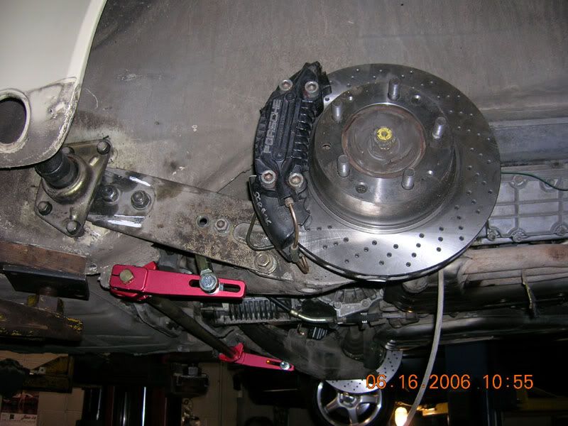

Just posting a few pics taken today at the shop (Rudtners Racing) where the bastardization of a real clean SC has begun. You know, I feel no remorse except that I should have done this sooner
Elephant suspension, 930 brakes, MA Shaw FG bumpers, 6 pt harnesses,Cobra seats, big front mount oil cooler......waiting for the Brits to fab the Safety Devices cage.

Holy cow. That thing is going to stop like you threw the anchor out.
Is that the IROC airdam with the jumbo-size cooler? I just bought a giant cooler too, lower oil temperatures = more power. The RUF spoiler is the most aerodynamically efficient but I like the brake ducts you have there. Will you have Bill do up some clamshells to blast air on the rotors?

Looks awesome. One question though, why did you go with slotted front and drilled rear rotors?

It seems that drilled rotors have a tendancy to crack with the heat cycling. I've been told by people who know more than I that slotted are more durable and work as well as slotted. The rears do not generate as much heat as fronts.

thanks, mike. what kind of tail are you going to use?
jtp911
Old 06-18-2006, 07:54 PM
Slippery Slope Victim
NY65912's Avatar
Location: Brooklyn, NY USA
Posts: 4,398
Duck, but willprobably go with an early (IROC) whaletsil in the future.

Those exact bumpers are going on my SC this week!
What did you do about:
Marker lights for the front
License plate lights
Which oil cooler are you using?
'82 911SC racecar
'05 WRX STi
Old 06-19-2006, 04:22 AM
NY65912's Avatar
Posts: 4,398
jaydubya....
probably no marker lights for front as of yet.
I'll be using a lighted plate frame for the rear plate.
The oil cooler is a bar & plate type......Performance Products have it in their catalog under the B&B name for $725.00, I found mine in the rain at the Hershey swap meet for $50. I sent it out to Pacific Oil Cooler for cleaning.
What to do about the front license plate??? That is the question.
MikeČ
1985 M491
Old 06-19-2006, 04:35 AM
jaydubya's Avatar
Join Date: Apr 2005
Location: Park City, UT
Posts: 946
No front license plate for me - haven't had one on either of my cars here in Utah for 6 years and have never had a problem.
The shop that's doing the work (Air Power Racing) went with the Smart Racing oil cooler.
For license plate lights on the rear I picked up a pair of the Lite'n Bolts.
Supposedly the shop knows where to get a dual bulb replacement for the front turn signal fixture that will do both the marker light and turn signal light.
