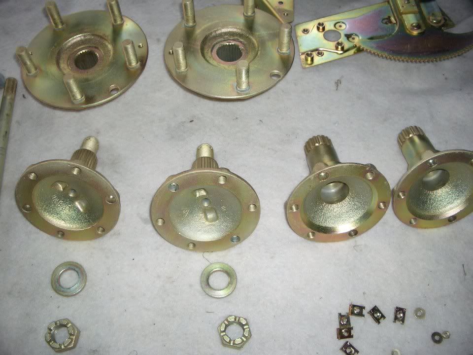

You may be right, Mike...one hub DID seem to have a bit of a rough spot. Maybe I should get out the cheater bar and take the hubs off and do the bearings...I could plate the hubs while they're out!

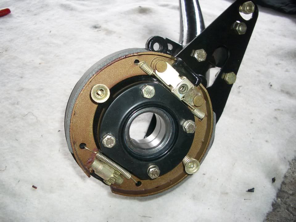

Looks great. The rear hubs, and brakes are easy to do "while you're there".;) You must be really looking forward to fitting the motor and getting the car back on the road.

Nice Hubs Alan!
Dave, my comment about the hubs was a cheap shot, sorry about that:) At the time it sure made me feel better about my sickness though. It sure is going to be a stunner of a car, I'm always most impressed by cars where the owner has done the work themselves.
