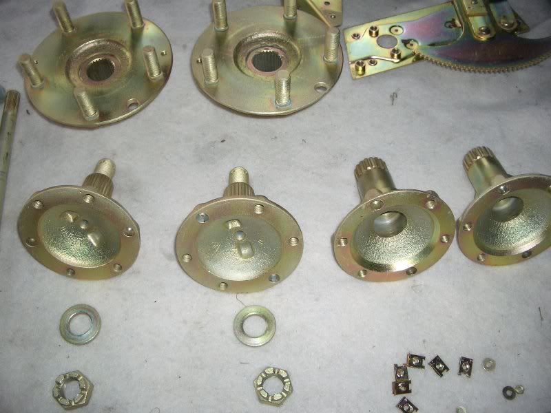

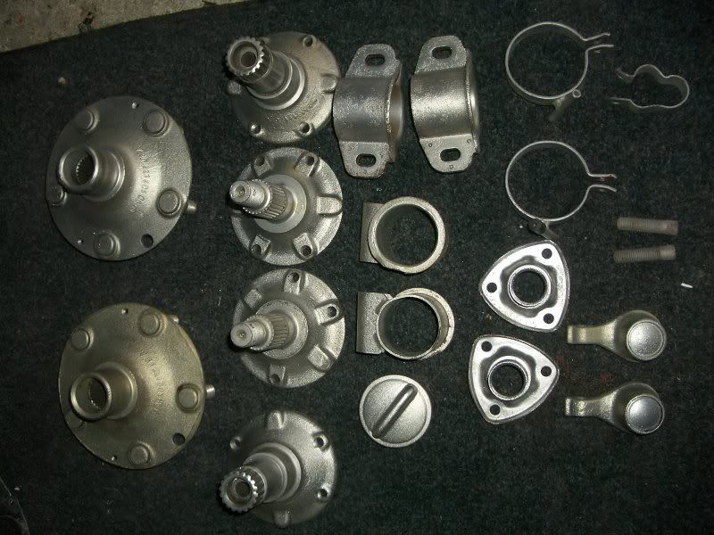

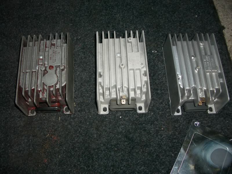

Just found these pics which were taken when testing different blasting to see what finish was best suited.
Just for interest sake, the first is cleaning by hand, yuck! and very boring, then fine grit and then vapour blasting. The vapour leaves a nice factory looking finish.
I also get most things done also before they get plated as it gives a much better and stronger finish. Items which are placed under high stress are also baked to prevent embrittlement.
Some parts after vapour blasting but before plating
Same bits after plating

"The vapour blasting method combines water pressure with air pressure and selected glass beads. This gives a much harder, wheather enduring, silky sheen finish. By comparison, conventional beadblasting gives a dull powdery finish which both stains and wheathers much quicker. "
I borrowed this text and hope it helps.

Randy, with aluminium, I get re-anodized. I think the S callipers were done in this pic.

While I remember if you anodize S calipers make sure they cover the steel pins.

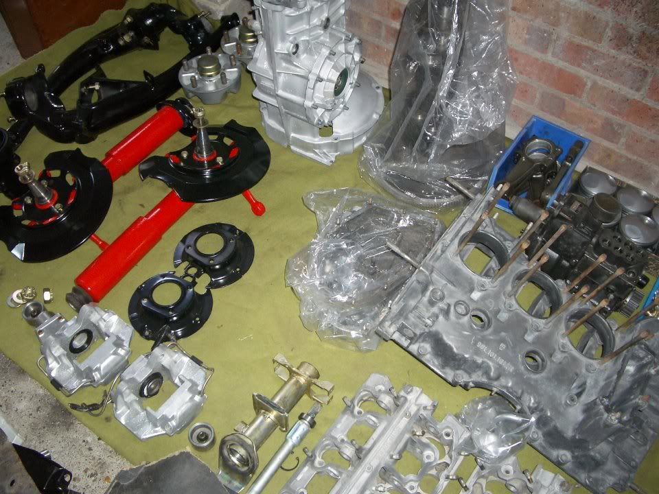

I have done most of the parts but the shell still needs some work. Stripping the under seal by hand takes some work but it is a RHD 70S, one of 34 (I am informed) produced. Since the picture was taken the car has been completely stripped, blasted and etched. A lot of new Porsche panels are on their way.
