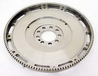

The Patrick MS LW flywheel for a G50 looks like this
http://i14.photobucket.com/albums/a3...ernau/LWFW.jpg
It may not be representative for 915s but the amount of material removed is not that much. As Souk suggested above, I went for an Aluminium pressure plate and a 930S clutch on my G50. Its substantially lighter and everything spins up faster. I also rebuilt to a spec producing 40hp more so its hard to say if the clutch/PP change has made a lot of difference.
