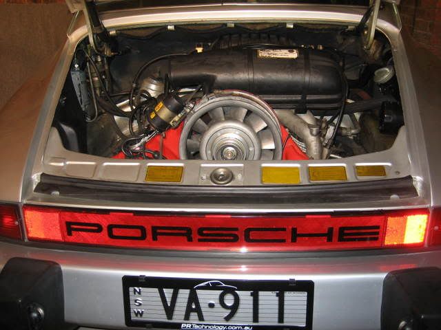

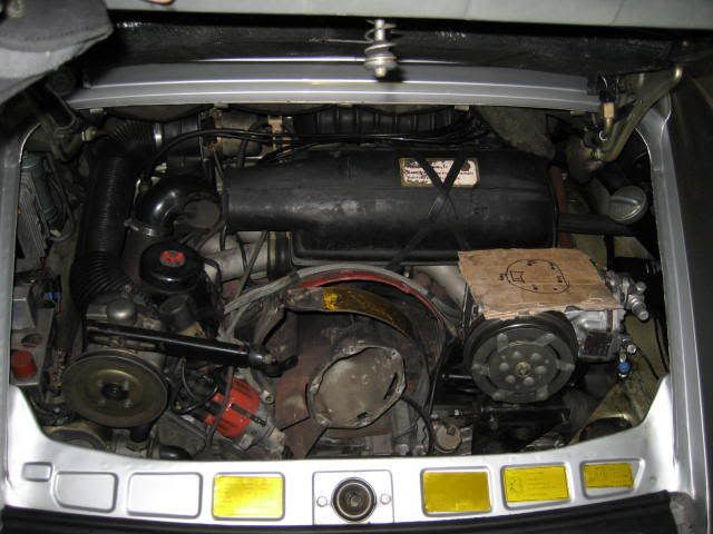

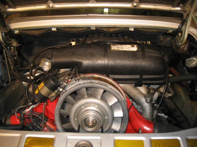

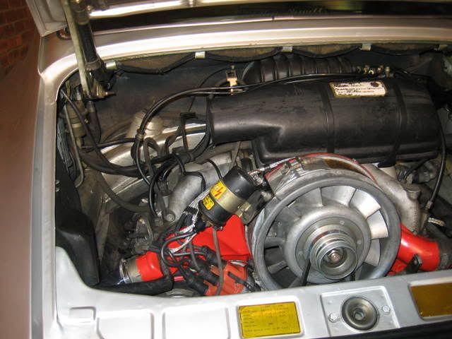

just finished backdate of heat and uncluttering of engine bay.. i have some pics of all stages of this. How much better is this?
First pic is how i bought the car but with the alt pulled. (shows aircon and air pump and heating)
Next is aircon and air pump pulled
Now heat backdated!!!!

Nice work and a very cleaned up engine bay!

Did the same to mine and love the difference. I can actually get in there to see and do things!! Great looking car!!

my backdated heat can bake bread. maybe not at idle, but on the highway, i only pull up the passenger side lever.

heat blower was disconected before due to a gremlin. When you turned it on the starter ran. yeah go figure that one. I havent tested it yet but i will keep you all posted.

Looks like the cruise control is gone too... Looks just like my car...
Now that big airbox and all the CIs stuff is just in the way ;-) I'm thinking carbs. That would really clean up the engine compartment !!!

john. you can cap it off with the use of a COKE can cut in half and a hose clamp. But seriously it only took about 2 hours to do the whole job. May take longer if you have the air pump and aircon in the way.
