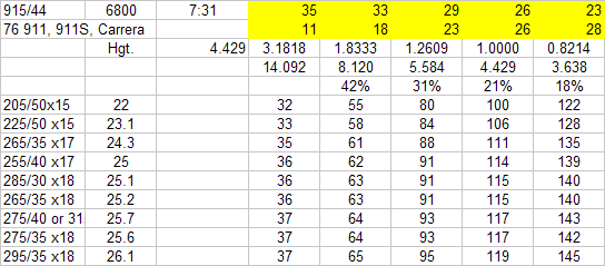

What I've noticed in going this same route (used to run 225/50-15s in the rear and now have 275/40-17s) is primarily two things.
1. The increase in diameter will alter the gearing slightly
2. The increased rotational moment of inertia will rear it's ugly head
Both of these conspired to make my car feel more sluggish. The benefits were greatly increased traction. All in all, the larger tires and wheels resulted in lower lap times, so it was a good thing to do.
The difference in gearing is directly proportional to the change in diameter of the tires you choose. Within reason, I would not expect the ring and pinion loads to vary enough to cause a concern unless the tire size you chose was much larger than 25 inches or so (which, obviously a 255/40-17 isn't).
As for braking, I didn't notice a real change in performance other than the increased traction. I have stock Carrera brakes on my car and they are fine.

Yes, one reason I'm considering this upgrade is because of wheelspin. Sucks when the meat can't keep up with the horsepower, but there it is.
In the rear, I'm going from 15x8-inch Fuchs to 17x9-inch something or the other - most probably Rotas. The rear tires will increase from 225-50-15 to 255-40-17.

Here's a comparison of some different tires, the spec trans is an abortion 915/44 w/ 7:31 instead of 8:31 but you get the idea of what happens when different tires are used.
