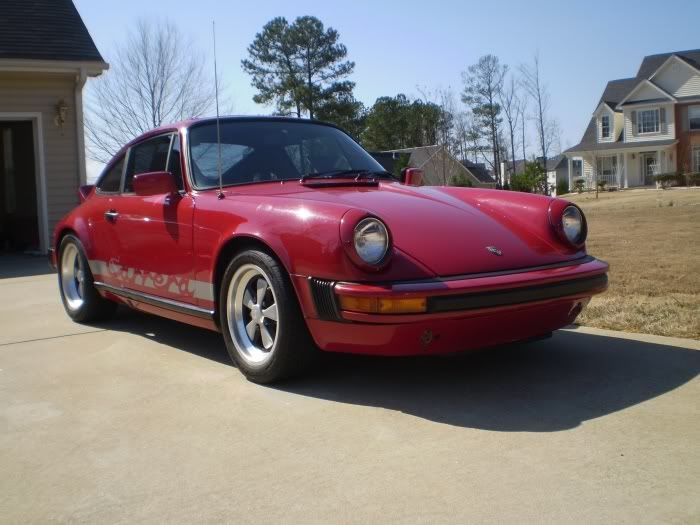

Originally Posted by Elombard View Post
I think it looks OK. Also Phil what about pulling the lower rocker trim? its kind of hit or miss on looks but definitley retro.
Erik,
I want to pull the rocker trim but when I was re indexing the the rear torsion bars I noticed the paint was not as sharp under it, so it will have to stay for now.
Thanks
Phil

Originally Posted by PSportoVeloce View Post
I think the silver would complement the car nicely because then it would match the wheel centers, which of course is a classic Carrera trick. Also black is pretty timeless/traditional on cars of all colors.
+1. White on red looks a little...strong. Silver will give it a more sophisticated look. More in line with the rest of the car.

Hmm....my vote would be to pull the rocker covers, repaint the area under the covers, then add the Carrera script in silver.
It doesn't take much paint to repaint that area. To make it easy you could get the paint in spraycans through Paintscratch.com and a few other places.
Silver it is, they are on the way. Headlights are next.
Also worth considering is black headlight rings...I think they look very smart on red cars.
Not so! the 74 and 75 Carreras also have Carrera side scripts.
I think they would look very cool on this car, but then I'm biased by my own backdate.
Your car looks awesome!

Nice work guys. Cosmetics aside, you NEED to match the front/rear spoilers. I can't see a tail on the silver car, so you might consider taking the front spoiler(lip) off and putting it on the red car. Running one spoiler without the other can lead to some dicey handling (dangerous) at speed.Cosmetically, I'd take the rocker covers off for sure. H4s will look great with painted rings to match the car. Opinions vary but the medium-dark cars look better with painted rings, while the lighter/metallics look better with chrome IMO.

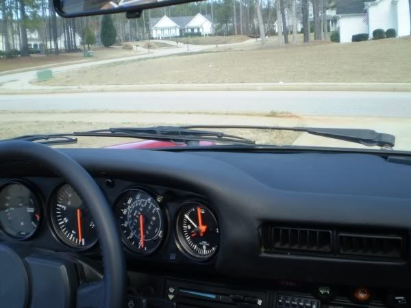

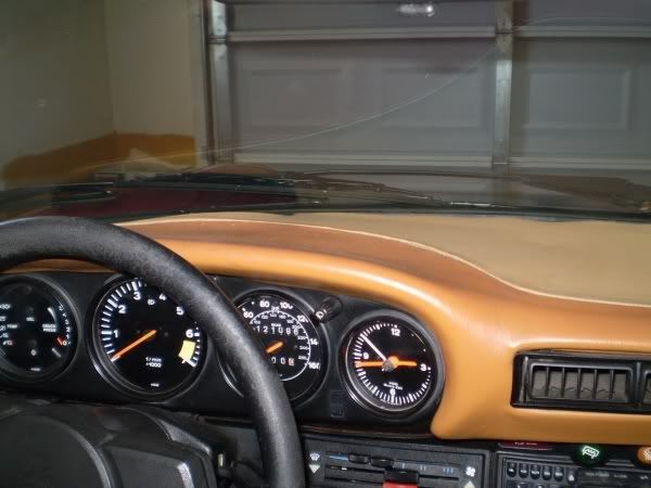

Got a few things done in the last couple of days.
Here is the dash before- Whoever did this spent some time recovering it in leather although the color did not match. The leather was stapled under the seem and bowed the dash out pretty bad.
And this is how it looks now. I will be going all black inside. Also did the wheel recover you can see it in the pic.
I also fixed the sunroof and replaced the gaskets for it as well.

Wow the dash looks great. What product is that? Or is it a brand new dash? Just wondering because my 69 is desperate.

+1 on info on the dash. My 73 has the plastic overlay and I hate it. Looks crappy and cheap. Yours looks great.
Well, I wanted to keep it a secret :^) JK.
It is a coverlay, but once I got it I did not like the finish, so I went and bought some Vinyl that we used to use when we worked with leather car parts to match up. I then glued it and fitted it to the coverlay. I had to trim the lip that is on the edges so it would lay flat after I wrapped it.
I used the real deal yellow glue from an upholstery shop so I do not know how available that stuff is to the public.

HA figures! Well it looks way better than the plastic finish it comes with. Now I have another project......add it to the list!

Nothing overly exciting this past week. Changed the Spark plug wires, added the script and some other small details.
The H4's should be here on Monday so I am looking forward to that change.
The script turned out pretty good IMO and here are a couple of shots of it.

Silver was a great choice for the script. Great with the wheels!

what do you think about selling those fuchs and going with the ROTA Fox 17s? With the short hoods they really work.
Looks great. I still think you should pop off the lower trim piece on one side if you can do it with out damaging anything and see what you think.
It looks fine as is though, the H4s are going to really make it rock!
My goal is that it only stays a short hood past the summer.
