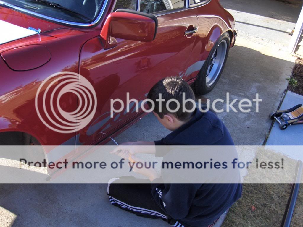

Originally Posted by w21055 (Post 3874688)
Finally an update with some pictures.
I had to replace the windsheild after the debacle on trying to switch trim on both of my cars. I must have been extremely lucky (hard to imagine with how things have went with this car) as the windsheild install was a breeze, did it by myself in about 20 minutes. While the glass was out I painted the lip that the windsheild mounts in so it is good to go for a while.
Here are a couple with the h-4's painted to match.
http://img.photobucket.com/albums/v2.../80scdriv2.jpg
You can also see the trim has been stripped.
I also decided to dye the interior to black from cork since I recovered the dash.
http://img.photobucket.com/albums/v2...4/int911dr.jpg
http://img.photobucket.com/albums/v2.../int911ins.jpg
http://img.photobucket.com/albums/v2...4/intrear1.jpg
here is how the engine looked before and now (still some work needed here)
http://img.photobucket.com/albums/v2...j4/engine1.jpg
http://img.photobucket.com/albums/v2...j4/engine3.jpg
And to finish last week, I installed a new muffler I got from V8 Ranch from the board here.
More to come. The fender hunt has just stalled and it will probably look like this most of the summer.
Thanks for all the feedback and help so far.
Phil

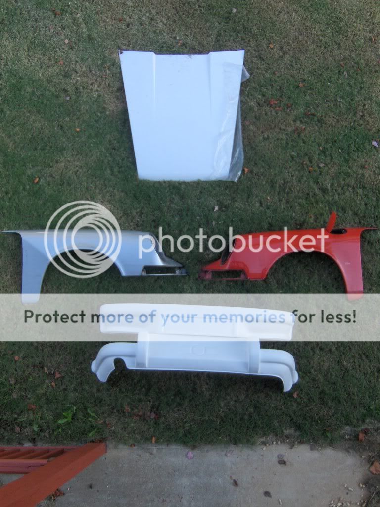

w21055 10-26-2008 03:17 PM
Ok feel like I have been doing nothing, other than spending money to acquire parts. In the market for a painter but here are the parts I have already.
http://i309.photobucket.com/albums/k...kj/sdcc142.jpg
Shaun @ Tru6 10-26-2008 06:39 PM
subscribed. Man I miss that fender. Phil, did you get the pics I sent? I'm going to soda blast them all this week.
Doug&Julie 10-27-2008 04:21 AM
So where did you find those fenders? ..other parts?
w21055 10-27-2008 06:20 AM
Erik and I ordered the fiberglass together to save shipping money. Mine is the longhood with short hood frame.
I got one of the Fenders from Shaun on here and another one was on ebay with a crazy high reserve and I was the high bidder with only a couple of bids so I got it for a very reasonable price.

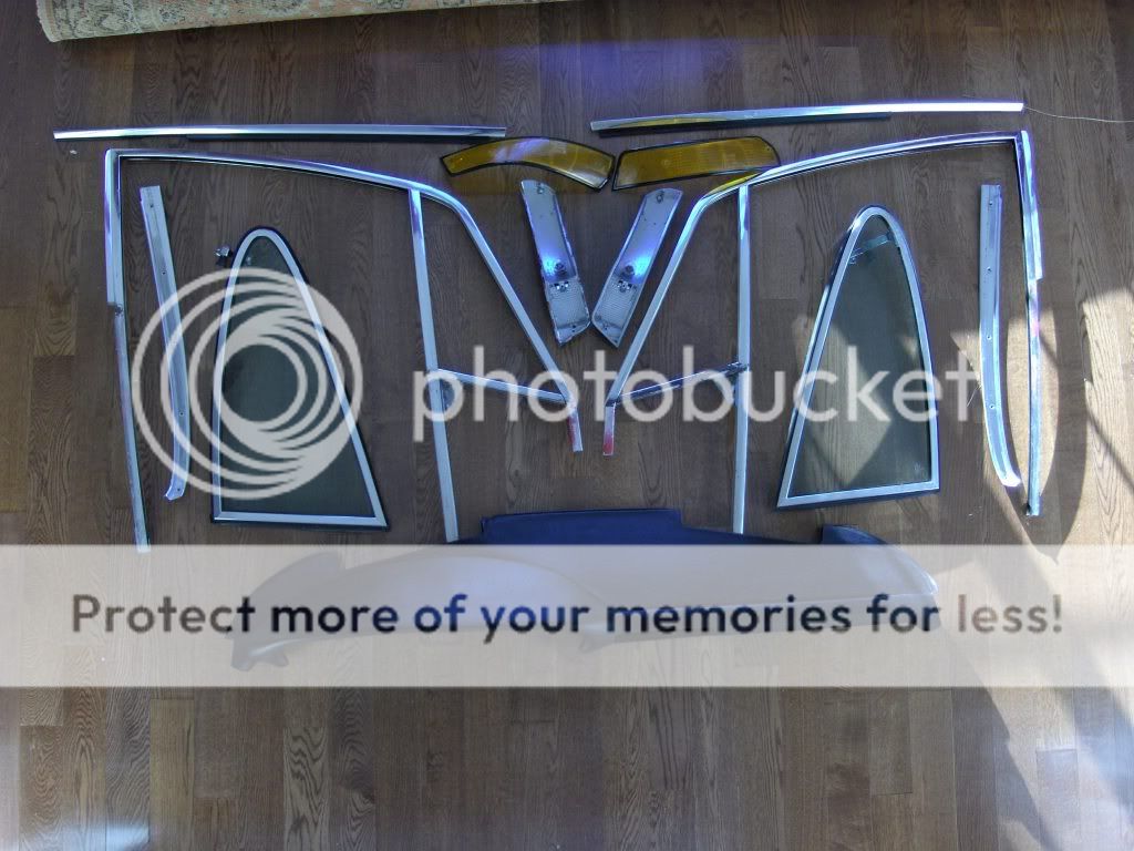

w21055 11-02-2008 05:13 AM
The list of parts needed are down to weatherstrip and that may be bought after the paint. We will start tearing the car down this friday. Even though I like how the dash turned out, I would rather swap the dash for another one so I got one on here.
I got these parts in this week all from Pelican folks so big thanks.
Dash-silver911rdb
Turn signals-sparkle84
Chrome door trim and pop out windows- eprnjp
Again thanks so far to everyone who has helped out and supplied parts, it has been pretty fun up to this point running everything down!
http://i309.photobucket.com/albums/k...kj/sdcc145.jpg
Thanks
Phillip

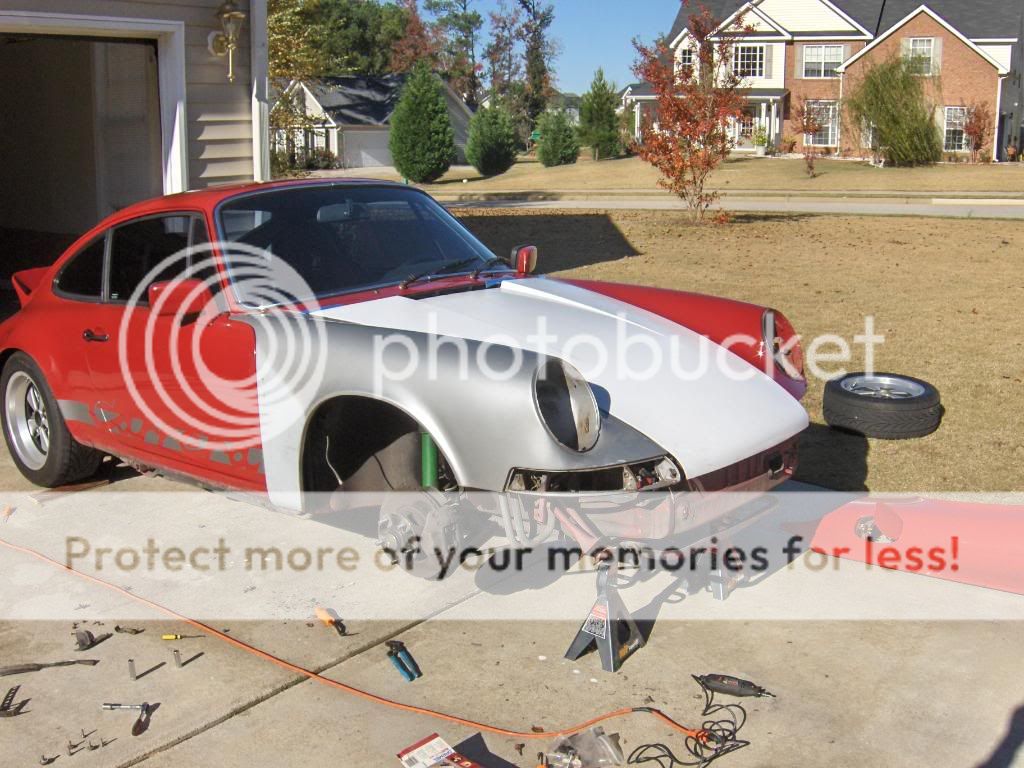

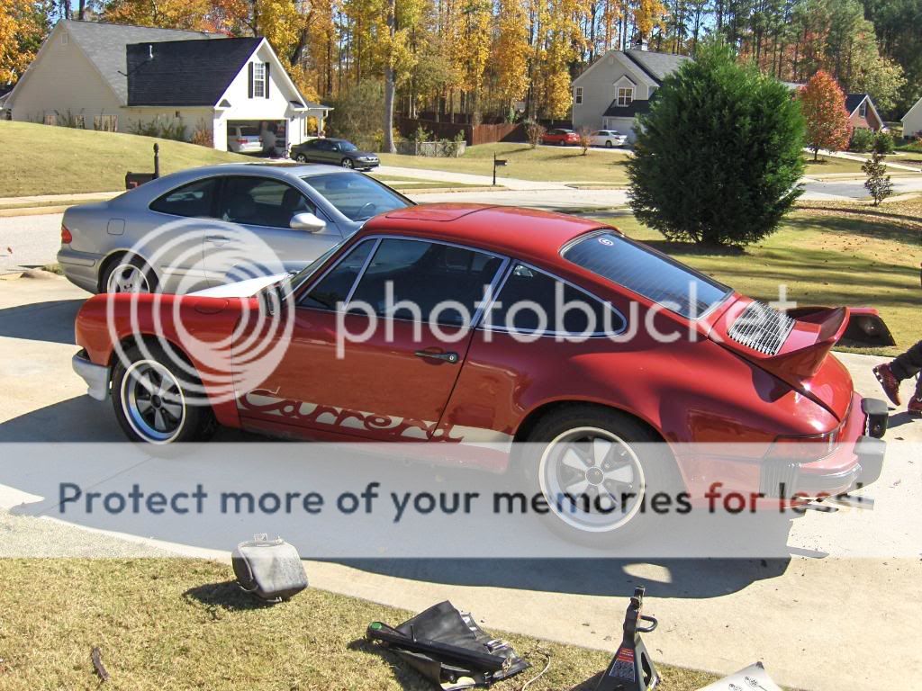

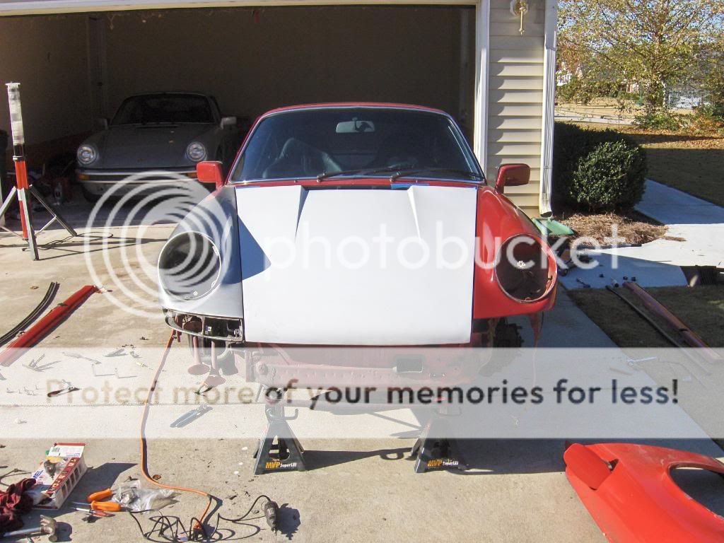

w21055 11-08-2008 06:52 AM
Teaser pics. Got a good bit done as of this morning. I had to wait on my helper to start so Last night we took the front end apart. So far nothing has stuck out as odd, I was fearing some rust or previous damage as we tore the car down but so far very good shape underneath the dirt.
http://i309.photobucket.com/albums/k...kj/sdcc175.jpg
http://i309.photobucket.com/albums/k...kj/sdcc176.jpg
http://i309.photobucket.com/albums/k...kj/sdcc177.jpg
Any tips from the experts would be greatly appreciated.
Thanks
Phil
Joe Bob 11-08-2008 07:53 AM
I have multiple colors for the Carrera side script.......just ask. If you see an interesting color I can probably order it and cut it for you.....special orders don't upset us.
w21055 11-08-2008 10:30 AM
Mike,
I will be getting a set of graphics from you shortly.
Front end is mocked up. Went pretty quick, the hood fits great passenger fender fits great, drivers side is not a perfect fit, but should be massaged in.
With the Guards red fender on you can see the difference in my paint and the standard.
http://i309.photobucket.com/albums/k...kj/sdcc179.jpg
http://i309.photobucket.com/albums/k...kj/sdcc178.jpg
