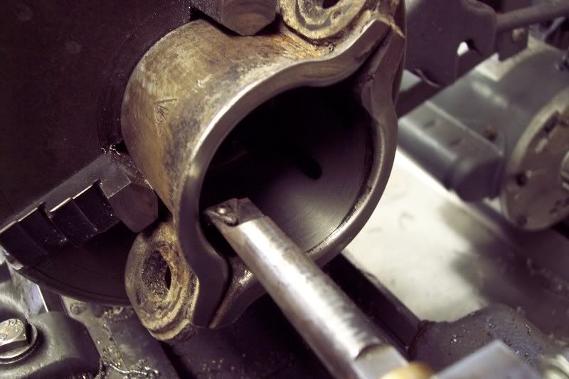

Hi,
Started to work on the suspension of my completely dismantled 911T '69.
I bought a while ago the well known Poly-Graphite bushings for front A-arms and rear spring plates.
Both front and rear the fittings of these bushings are that tight that I need quit some force to mount them on the A-arms and then inside the control A-arm mounts!
Should they been machined before? (They are flexible so how should they be clamped during machining?)
If yes, how and what size / tolerance (play)?
If someone has experience, please tell me, I want to finish the suspension restoration ;-)
Thanks already!
Bart

Here's one way to install polygraphite bushings:
Front Suspension R&R with polygraphite bushings ala Souk!

Yep, Souk got it right. The lathe to fit is the way to go. I prefer to press the bushings into their collars and then make the ID round so they fit the a-arm. You can use whatever method you want to remove material but they need to be fit to the car. Otherwise its just a disaster of squeaking, popping and poor suspension articulation.
btw, if you do this by hand there are a few tricks. First, when you sand/remove material the surface will be rough. After you try to press them on and they do not fit the friction will create slight smooth spots where the bushing is proud. That is the first spot to start milling on the next round. Its a slow, messy project but not difficult and definitely cost effective.

Thats what we do, but first true up the hubs too. Install then bore to fit.

1.) for the plastic type bushings...you need to machine the ID to fit the A-arm perfectly.
2.) Not done. If you should now install the hardware "clamp" around the bushing with no A-arm installed ( this clamp that supports the bushing OD is made up of two clamshell type pieces that hold everything together... )you will note that the "clamp" will distort the perfectly machined ID to something other than "round". You're screwed.
3.) Install the outer support "clamp" around a bushing ( on the shop bench, without the A-arm installed... not in actual fact..), then notice the ID distortion. NOW try to machine ( method ?) the ID to get to the desired diameter and round-ness.
4.) Almost there. Install regreasable zerk fittings. Oh...maybe machine some groves on the ID to smear the grease around better.
5.) Cross fingers.....
That is a must. You have to have the bushings in their collars, THEN make the ID round.
Otherwise, you might as well make the bushings "round" by using a broomstick wrapped in sandpaper. Lathing the bushing while they are outside the collars is useless.

You are wrong. The bushing cold flow and fitting them with just the right amount of interference is the key.
Remember, the bushing is not suppose to rotate or twist during service! Milling the ID and boring the clamps is just extra work IMO.
