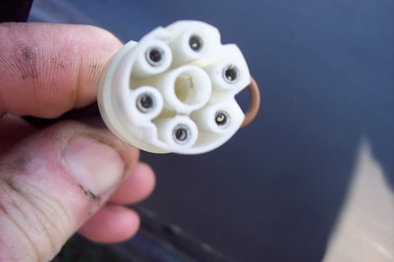

Mirror connertor tool
Book says there is a special wiring connector removal tool to get these pins out, is this something I can make? Shouldn't there be a tap in there that has to be depressed?

These work for me as well there are individual removal tools onesized for Each sized Hole.
I picked these up on sale for about $12.00.

I used a very small phillips head screw driver. they came out pretty easy.
Just don't put it through your hand

I just made a tool, piece of 1/8 inch brass tubing (from model airplanes) drilled out to .105 and it worked great, Mirrors are off..
