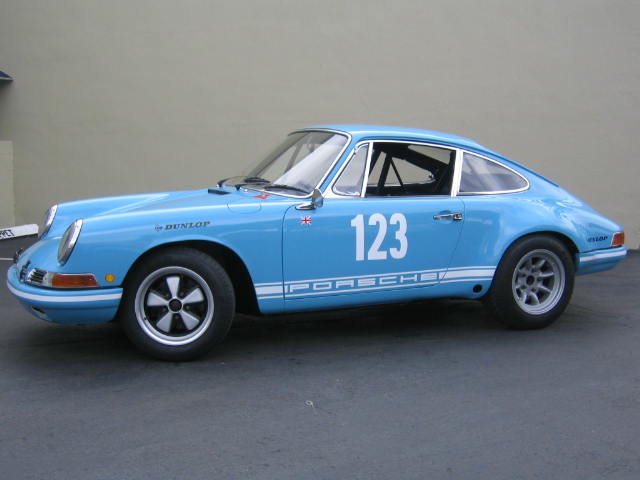

Chris - I very much look forward to the completed project. Please enjoy the pic of the white TR:

Thanks for the pic Bob! Yep, thats what I am shooting for but with lots of my own details and the "secret" paint scheme. Already have that muffler
