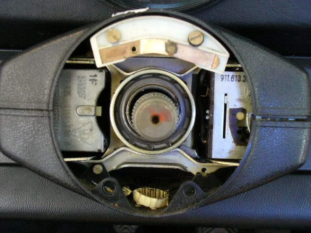

I finally got around to doing it today, and it really wasn't that difficult.
After removing the horn pad, here is what you'll see. Note the horn contact wire. It came loose as I pulled the horn pad off. Also, it was helpful to remove the horn relay before pulling off the horn pad.

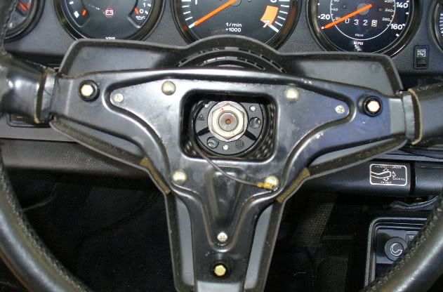

After removal of the steering wheel, you can see the remnant of the steering column bearing laying in the lower column cover. The masking tape at the top column cover was placed to help me correctly reposition the steering wheel. While I was in there, I replaced the missing screw at the lower right.

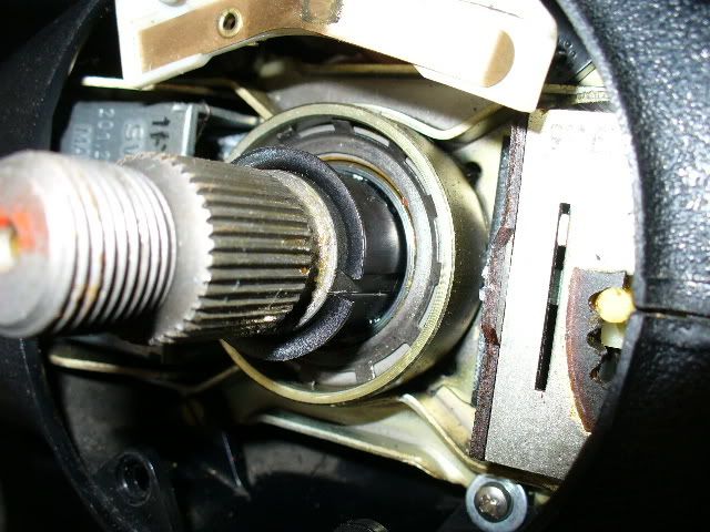

Here is the sleeve on its way in. I had to drive it in with a scrap piece of PVC. I lubed lightly it inside and out with Miltec firearm grease.
It was a simple fix, and I'm no mechanic.

is that sleeve black in color? mine was silver and doesnt fit tight. Please advise if this sleeve was black and if it made your steering collumn perfectly tight. thanks

It is black, yes. There is no longer any discernible play in the steering column after its installation.

anyway, seriously if you take the steering wheel in your hand, one had at 12 and one at 6 and try to rock the wheel, you have absolutely zero movement? if so, wow. i have never had zero since installing sleeve
mine is not black. its silver, or sort of nickle color. perhaps the dimensions are now different?

Check out John Walkers thread about the issues with using these. I have one and went with the lube to help but not entirely solve the problem.

the topic addressed in JW's thread also raises the same concern regarding sticking a feeler gauge in between the shaft and the sleeve...in my opinion. im hesitant to do that as someone mentioned i think above, though i am tempted

I just took a 0.10 feeler gauge and stuck it between the shaft and the sleeve. WOW !! now my steering is tight.
0.10 is a pretty thick gauge...so Im concerned and confused.
Im going to try to order the black replacement sleeve mentioned in another thread and see if its a tighter fit than the silver colored one I received from PP last May 2007.
Im wondering - are there two versions of the sleeve? and why is mine silver colored?
