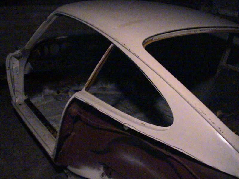

I'm a TN National Guard mechanic who recently returned from a stint in Kuwait and Iraq's deserts. I've been a european car owner (hence wrench turner) all my life. My 1966 6-volt Beetle in high school is indeed what truly taught me to be a mechanic years ago. Of course, for the Army I was repairing Humvee's, ASV's, LMTV's, and HETT's (Small to Large wheeled vehicles).
I got damaged 1968 shell a few years back. However, I had saved a decent chunk of change while I was overseas, with the intent of getting another 911 albeit complete this time.
