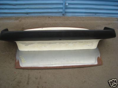

One thing to note: The Turbo Tail they refer to is the early Turbo Tail rather than the later 'Tea Tray' Turbo Tail which they refer to as the 3.3 Turbo. The early one was very similar to the Carrera Tail or 'Whale Tail'.
This is an early one:
Ian
'87 Carrera Cab My Rennlist Site
