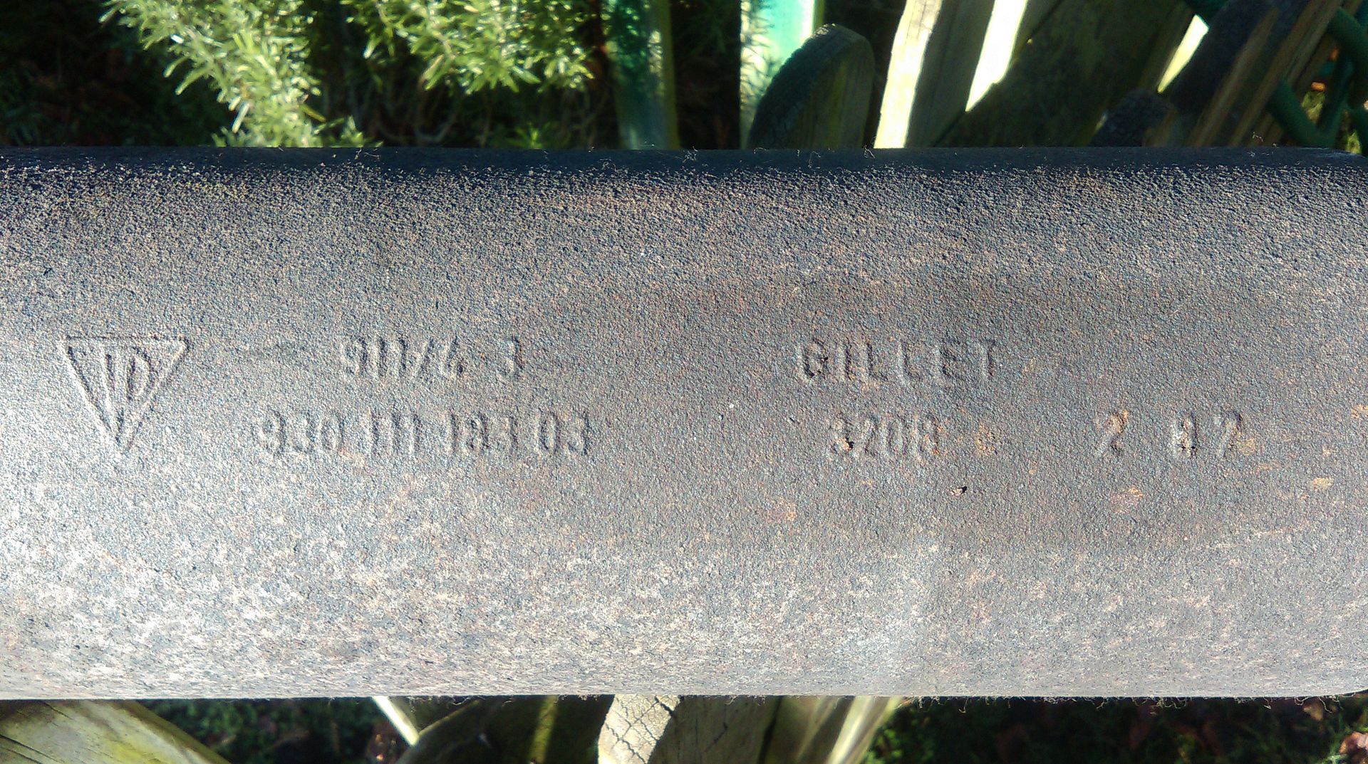

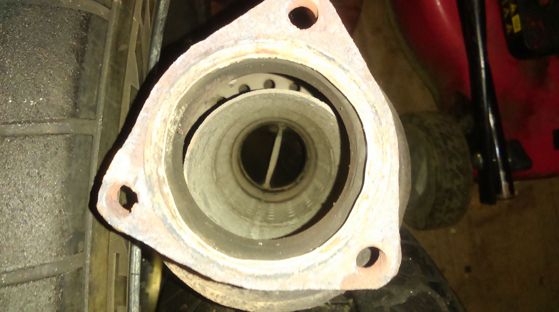

None of the factory euro pre-mufflers I have seen have any form of packing. They all consist of a straight through partially perforated tube (the same diameter as the outlet) that goes from the merged inlet pipes to the just short of the outlet flange (about 1" short). The perforated tube is held in place by a collar between it and the larger diameter casing. This collar is located about 2/3 of the way along the casing and also has perforations in it. Here are some pictures of a standard equipment Gillet pre-muffler.
http://i226.photobucket.com/albums/d...ps04vnbou7.jpg
http://i226.photobucket.com/albums/d...ps0eopnqvb.jpg
The internal pipe does line up with the exit flange, I have angled the camera to show the gap, collar and perforations which makes it look out of alignment.

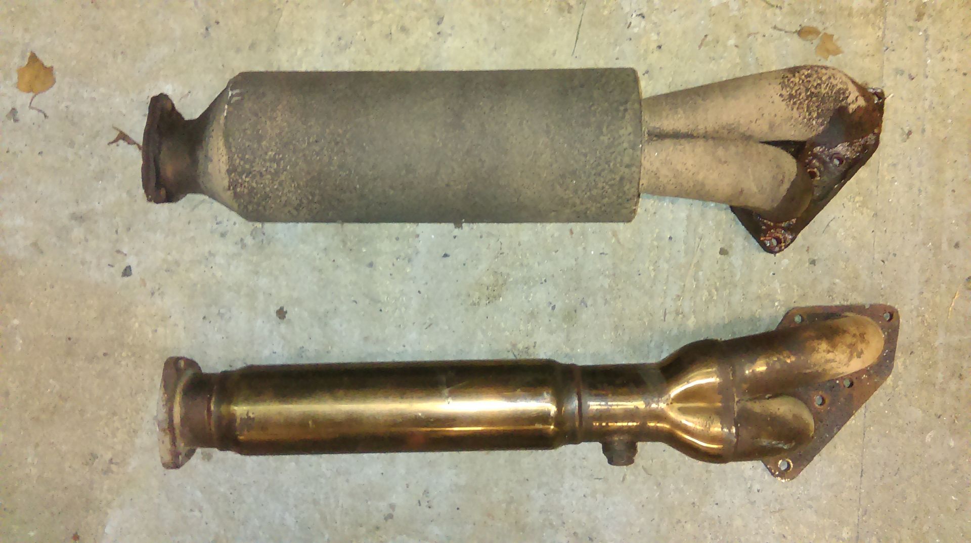

One of the advantages of changing to a pipe is a reduction of weight at the back. The pre-muffler weighs just over 13lb, the pipe in the picture below weighs 6.5lb. I guess the weight saving over a catalyst would be greater.
http://i226.photobucket.com/albums/d...pszg2uxcwy.jpg
For the record, I felt a difference in performance between the above pipe and pre-muffler on a chipped euro 3.2, but no increase in noise level. With the pipe it felt more responsive above 4K, but it may have been just a slight shift in power band rather than an increase in power. As for noise, I have a rather loud 2 out and that may have overpowered and difference between pipe and pre-muffler.

Here is the M&K Pre-Muffler (top) and Bypass Pipe (bottom).
Pre-Muffler has a packed muffler body, Bypass is just a pipe. Both are similar performance as ID is the same.
